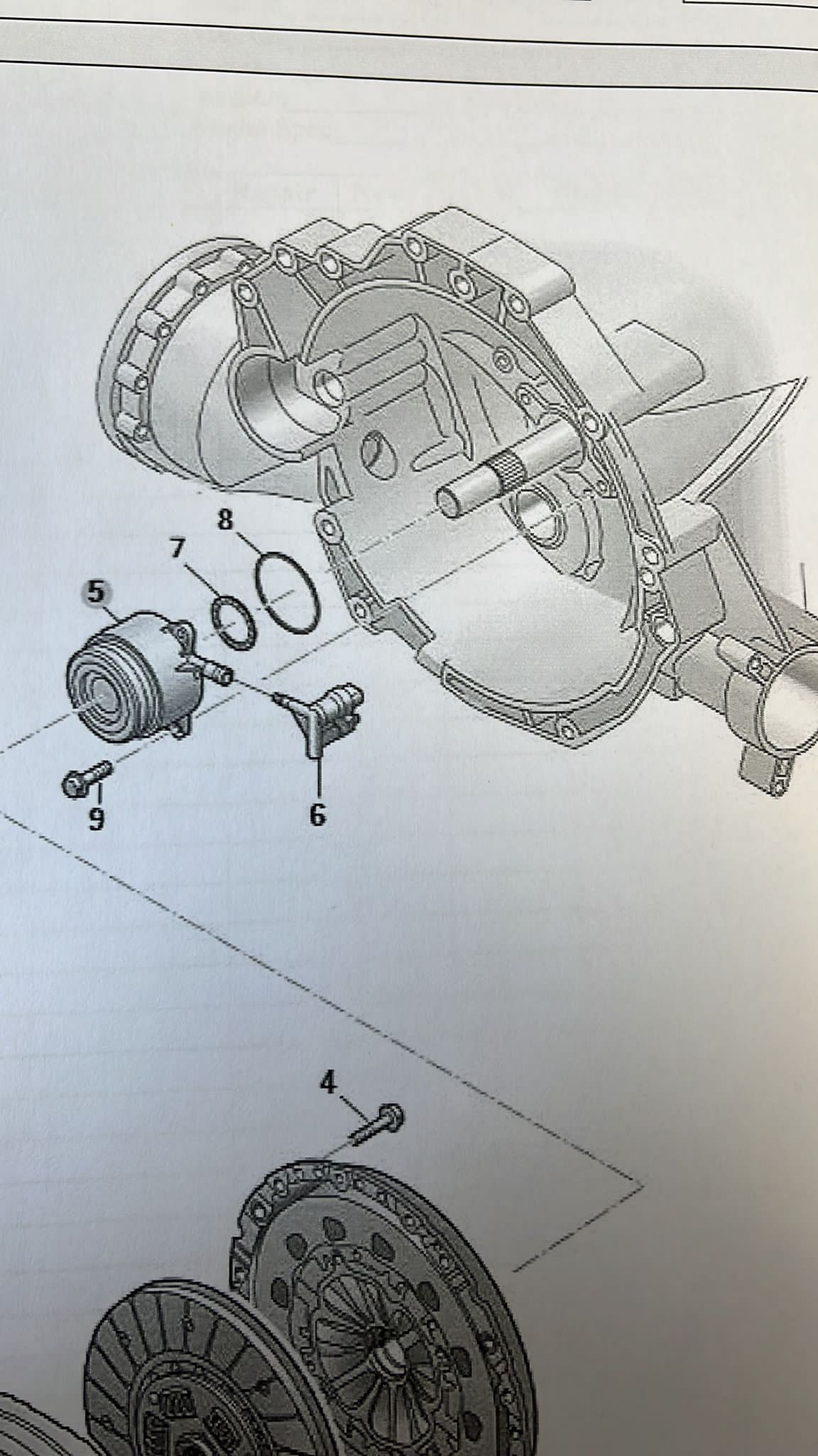

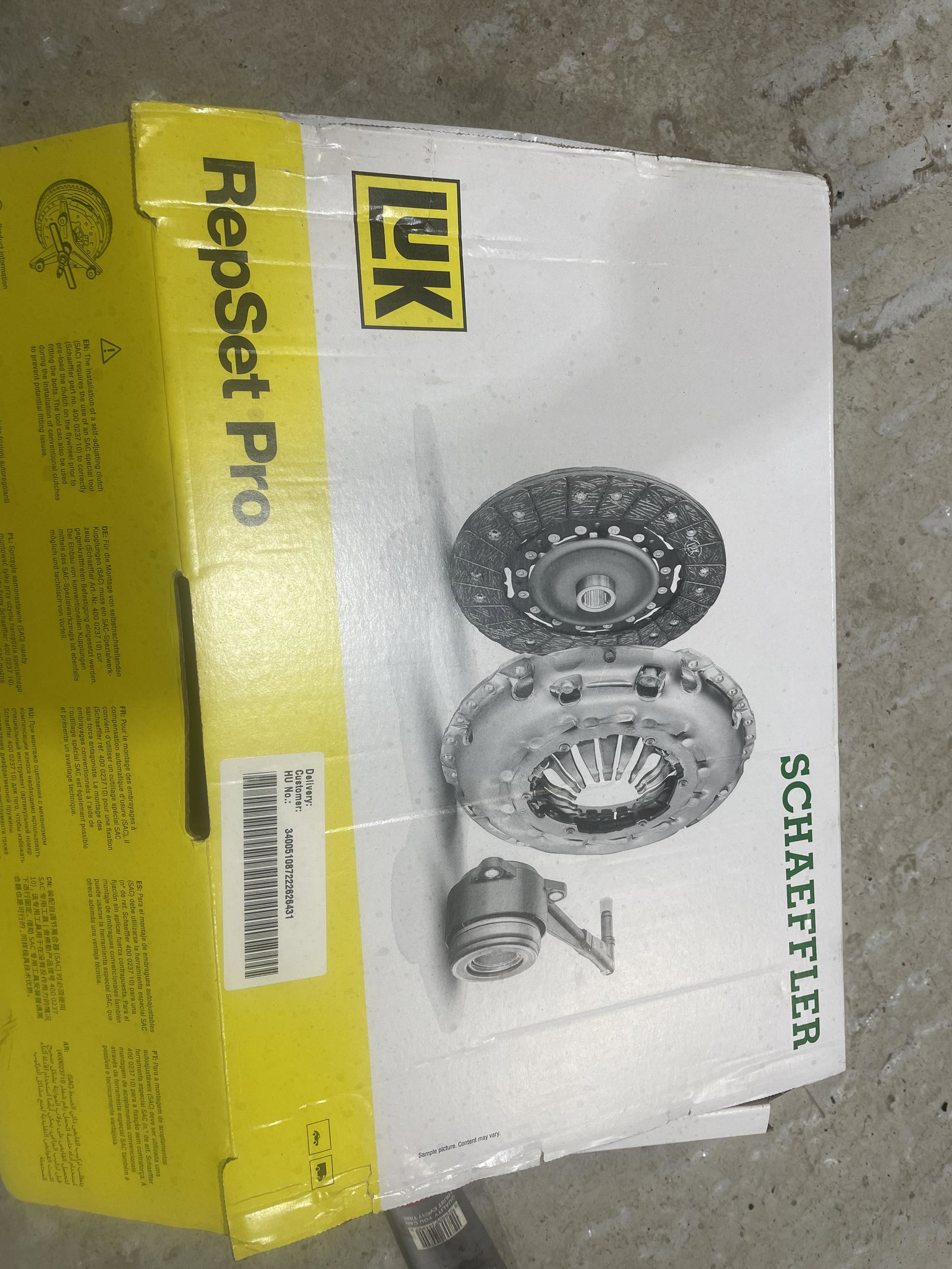

Sid2020 Posted Friday at 07:14 PM Posted Friday at 07:14 PM Your best to pop into a local motor factors. They don’t usually have websites that are much help as deal with trade customers over the phone mainly. I got my LUK clutch kit from Dingbro but I’m based in Scotland and mine is a diesel B9. Clutch kit for mine consisted of pressure plate, clutch plate and slave cyclinder. My dual mass fly wheel was fine and that’s after 120k. Dual mass fly wheels on these cars are off a new design so they rattle when rotated or shaken as is perfectly normal.

Sid2020 Posted 11 hours ago Posted 11 hours ago Usually when the part is out of stock everywhere like that it’s because it’s still under license to the car manufacture. So LUK can’t not supply it to third parties or even sell it themselves. LUK supply Audi so if Audi have stock then this will be the issue you will be having which is strange since the cars been on the market since 2017. Slave cyclinders are the same in all b9’s are far as I’ve came across and been available thru motor factors for a couple years
Sid2020 Posted 11 hours ago Posted 11 hours ago When I replaced a B9 tdi clutch 2 years ago all parts were dealer only but 3 months ago I got a clutch kit for the same engine from a motor factors but they did say it had only just became available
