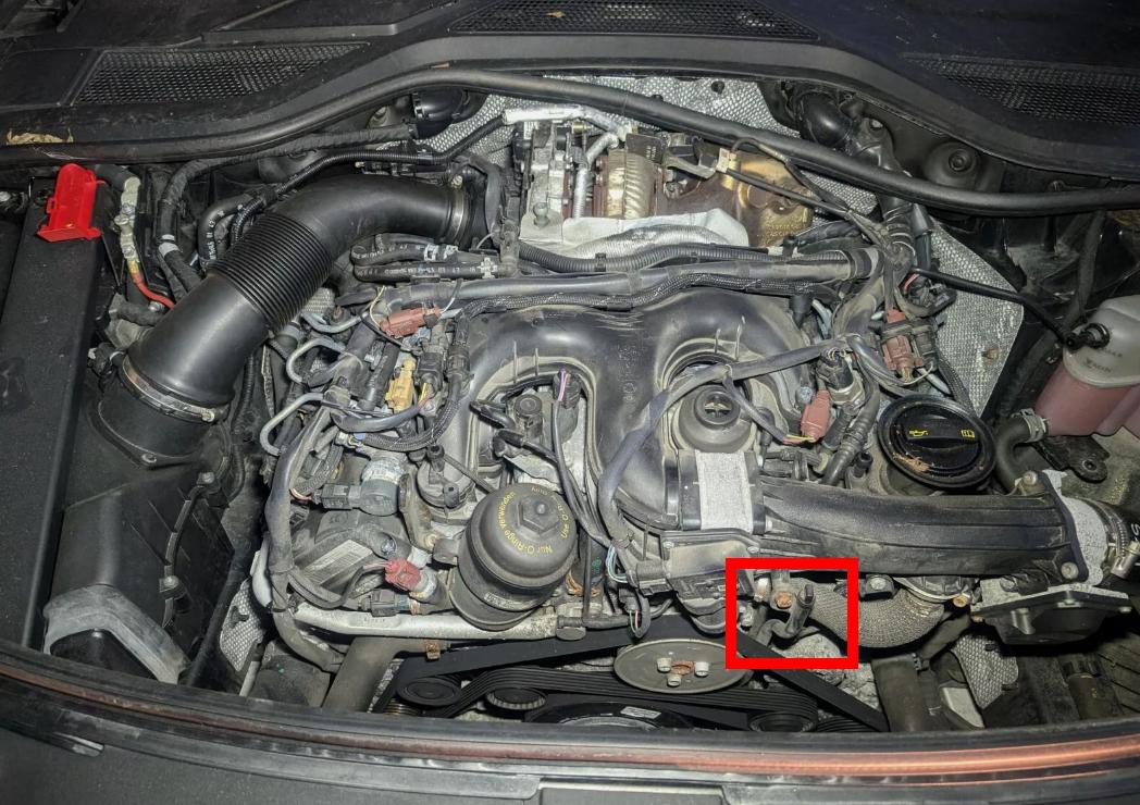

DRC27Wash Posted yesterday at 02:18 PM Author Posted yesterday at 02:18 PM Pic 4717 was taken after a stop for 30 mins after picking it up. Pic 4730 was taken this morning. Pretty sure I’ve got an oil leak, to back that up there is also a burnt oil smell in the cabin. Any thoughts what the problem may be? I am seriously considering taking it back for a refund.

DRC27Wash Posted 8 hours ago Author Posted 8 hours ago Does the Q7 have a dip stick? If there is one I can’t see it. Have been checking the oil level after cooling down for a couple of hours on the MMI, it’s dropped from 3/4 when I collected it, to as low as 2/5. There is a smell in the cabin I believe is burning oil.
Mark M. Posted 7 hours ago Posted 7 hours ago If you can't see an obvious dipstick then it's almost certain that you have a really helpful bung instead of one. I got an adjustable dipstick for my Q5 as it didn't come with one and I prefer it to trusting an electronic sensor. 1
DRC27Wash Posted 7 hours ago Author Posted 7 hours ago Hi Gareth, I say refund because of the smell and potential oil leak not the resultant oil level from servicing. Any idea why else could it be dropping so quickly? Cheers, Dave
Mark M. Posted 7 hours ago Posted 7 hours ago Oil is going to be leaking out of the engine somewhere, or being burnt inside of it, they're the only ways the oil level is going to drop. I'd go back to the seller (I'm assuming it was trade) and tell them your concerns, depending on how long you've had it will dictate what you can do with it. If it's within 30 days then you have a right to reject the car if it's faulty, not as described or not fit for purpose. 30 days to six months the seller has to attempt a repair or replacement but if that's not satisfactory you can still pursue a refund. Over six months it's all on you to prove it was faulty since purchase.
