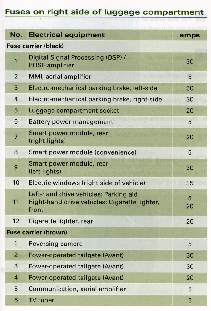

Canada Bob Posted August 17, 2015 Author Share Posted August 17, 2015 Strange... everything I've found seems to indicate that this should be the case. I'm assuming yours is different to the A6 in the second video of this link: http://www.carcarekiosk.com/video/2008_Audi_A6_3.2L_V6/fuse_interior/replace It appears that this car has a fuse box at each end. Some have a box in the boot too. The fuse box for my car is in the boot, and as seen in the video there's no diagram on the back of the cover, just some sound insulation stuff. To make things worse the Owners Manual doesn't have a diagram of which fuse goes where, that's in the Service Manual, the one that I don't have :-( Quote Link to comment Share on other sites More sharing options...

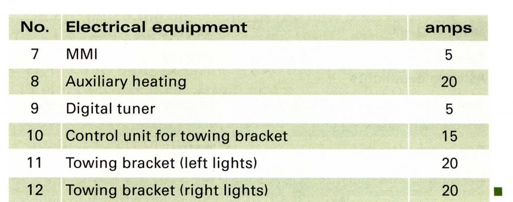

James Posted August 17, 2015 Share Posted August 17, 2015 The fuse box for my car is in the boot, and as seen in the video there's no diagram on the back of the cover, just some sound insulation stuff. To make things worse the Owners Manual doesn't have a diagram of which fuse goes where, that's in the Service Manual, the one that I don't have :-( Is yours the one that has a black and a brown fuse carrier? If so, I may have found something: Quote Link to comment Share on other sites More sharing options...
Canada Bob Posted August 17, 2015 Author Share Posted August 17, 2015 THANKS for the above James, that's exactly what I needed, much appreciated. Bob. Quote Link to comment Share on other sites More sharing options...

Canada Bob Posted August 18, 2015 Author Share Posted August 18, 2015 I bought the car somewhat recently and on looking in the boot/trunk I found a 20 amp fuse in the wheel well area, wasn't sure if it was a spare or if it had just dropped out, so I needed a "map" to check what should be where, folks don't always put the right fuse in the right place, everything is fine though now. Quote Link to comment Share on other sites More sharing options...
