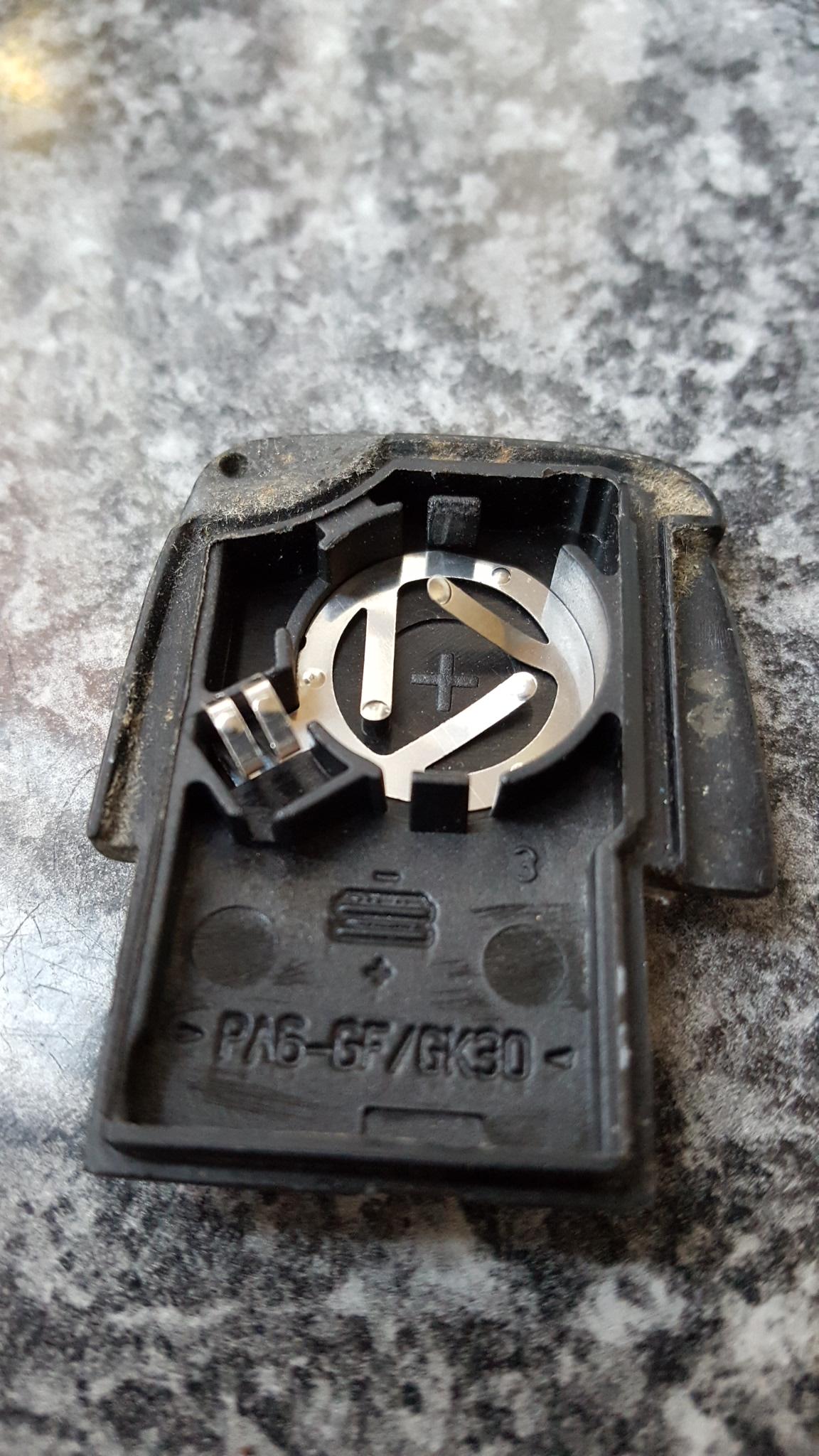

James1980 Posted March 19, 2017 Posted March 19, 2017 Hi All, Just bought a Audi A3 year 2000 model. The car won't lock or unlock even using the key in the drivers door. I only have one key. Opened up the key and no battery is inside. I've been looking around on the Internet to see which battery type it might be but the CR2032 is totally the wrong size. Any idea what the battery size will be? I've added a picture if that helps. Cheers James
Audi Owners Club. Posted March 20, 2017 Posted March 20, 2017 I can see CR1616, CR 1620 and CR2032 listed for the fobs, not sure which one is right for yours though. got a feeling it takes 2 batteries
James1980 Posted March 20, 2017 Posted March 20, 2017 Thanks Trevor, Well the CR2032 is to big. I've just ordered a couple of CR1620 batteries. See if these are the right size. Otherwise I'm off to Audi. Any idea how much it'll cost to get the key reprogrammed and a new battery? Or does anyone know who provides that kind of service? Many Thanks, James
Audi Owners Club. Posted March 21, 2017 Posted March 21, 2017 Not sure of cost for reprogramming but here is some tutorial information for initiating the remote after battery replacement that might be of some use
James1980 Posted March 21, 2017 Posted March 21, 2017 Great thanks for that Trevor. Just for info I spoke to Audi today and the battery is CR1620 x 2. Conveniently that is what I've just ordered on eBay. For the cost of a new key and to get both the original and the new key reprogrammed it'll be £168.72 Inc VAT. Not to bad I think. I'll wait for the batteries to arrive then see if it works. If not I'll get a new key from Audi. Cheers. 1
