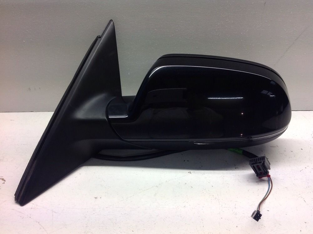

jdragon Posted September 5, 2015 Posted September 5, 2015 Can anyone please tell me why some wing mirrors have one plug, while others have two (photo attached)? Would it be one for electric, and two for both electric and heated? 1
James Posted September 7, 2015 Posted September 7, 2015 There would also be the power fold option and the indicators if it has them in the mirrors
jdragon Posted September 7, 2015 Author Posted September 7, 2015 What would that mean in terms of the plugs? I'll explain my situation: the car has the wide view driver's side wing mirror upgrade and so it looks different from the passenger's side, which doesn't sit well with me. Not wanting to spend a £100's on a new wing mirror to match the passenger's side, I'll be taking a punt on a used item. My mirrors are heated and have the integrated indicator but they aren't (I think?) power folding. My questions are, if my mirror has one plug but the replacement comes with two, will the heat and indicator still work? And if the second plug is for the power fold (which my car does probably does not have) will I still be able to fold it manually?

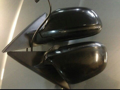

jdragon Posted September 8, 2015 Author Posted September 8, 2015 Unfortunately it's not that simple. The driver's side wing mirror unit is bigger too. I've copied an image using my phone so I'm not sure how good the quality will be, but it shows the difference in the set I have.
James Posted September 9, 2015 Posted September 9, 2015 Oh I see. I take it you haven't yet tried taking your apart to try and establish how many plugs yours has?
jdragon Posted September 9, 2015 Author Posted September 9, 2015 No, but only because I don't like to the same thing twice if I can avoid. I've risked it and bought a two plug wing mirror, which arrived today, and it folds manually so at worst I'll have a lose plug behind my door card. I'm going to fit it Saturday morning so I'll report back either way ;)
James Posted September 10, 2015 Posted September 10, 2015 On 9/9/2015 at 7:43 PM, jdragon said: No, but only because I don't like to the same thing twice if I can avoid. I've risked it and bought a two plug wing mirror, which arrived today, and it folds manually so at worst I'll have a lose plug behind my door card. I'm going to fit it Saturday morning so I'll report back either way ;) Sounds good, I'll keep my fingers crossed for you that everything matches up! B)
jdragon Posted April 8, 2020 Author Posted April 8, 2020 Interesting thinking back to this now - a risky strategy but it paid of in this instance. My next query is one I probably won't be so brave with 😄
