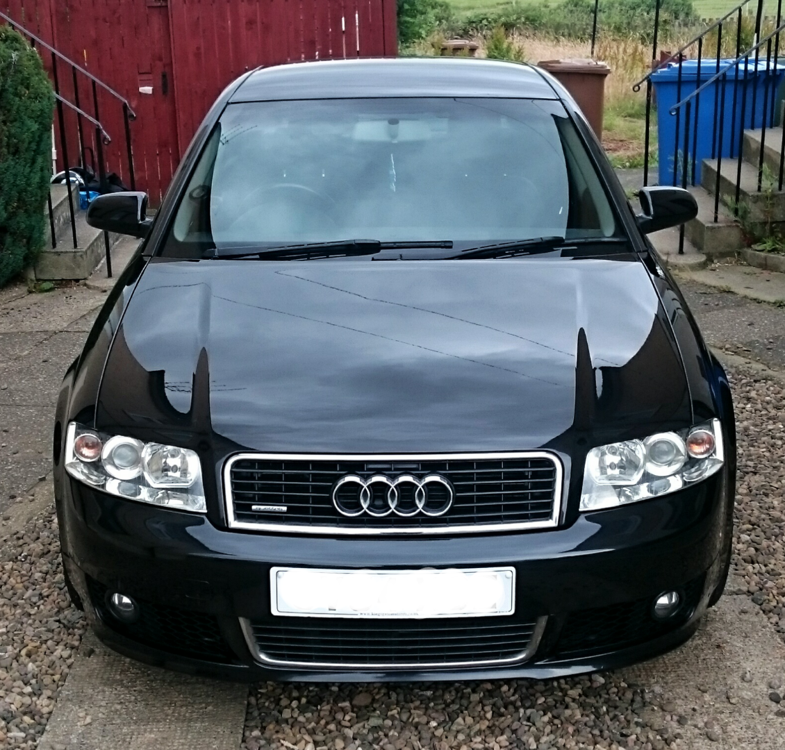

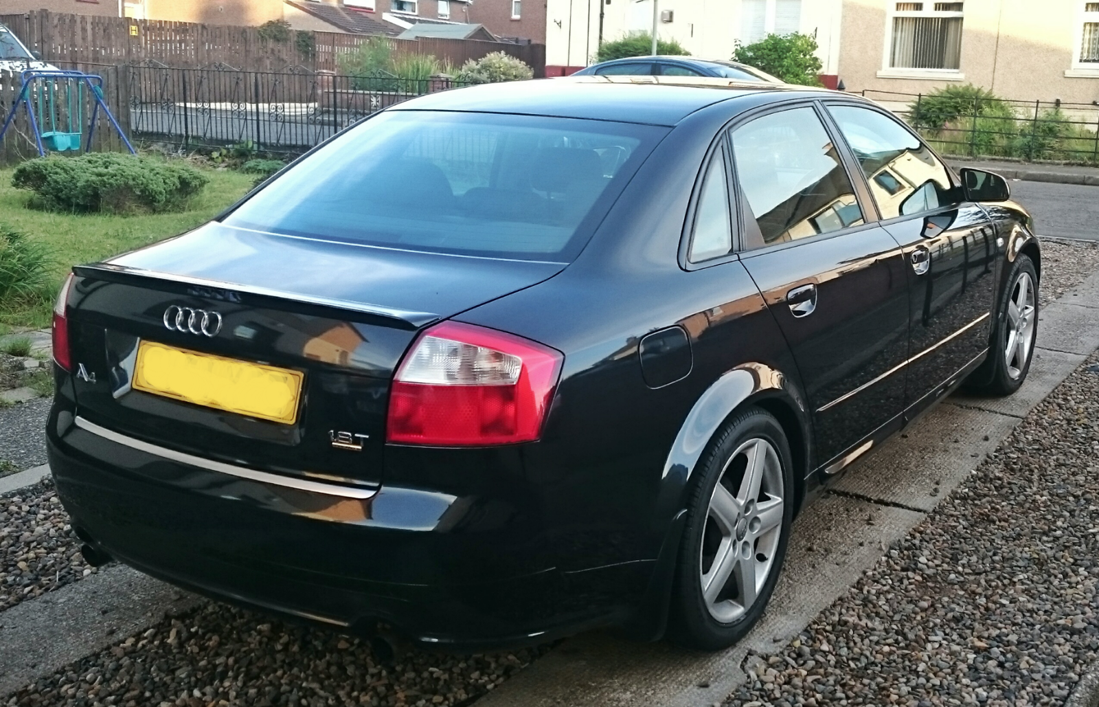

BigTazScotland Posted July 20, 2016 Posted July 20, 2016 Hi newbie from Scotland my name is Paul Just got my first 2004 Audi 1.8 turbo quattro. I got it last week and so far I have had to do the following Front top arm and pinch nut Cv joint 2 rear wheel bearings 2 brake lines New rear rubber exhaust y mount Had it remapped to 200bhp with 282ftlb Torque. I still have a few things to do to it, firstly Aircon won't switch on and is stuck on "econ" i believe that this is a common issue with high pressure switch on the the condenser ( feel free to let me know if that's wrong, it's gassed with no leaks) And it has a cat back stainless steel exhaust system no middle boxes and 2 twin rear boxes, but it is loud so will try and source an original one
Audi Owners Club. Posted July 21, 2016 Posted July 21, 2016 Hi Paul...welcome to the Forum! The car looks great and amazing condition for it's age. The aircon pressure switch does make sense and worth trying a replacement...especially in this weather. Keep us informed with any updates Regards Trevor - Admin 1

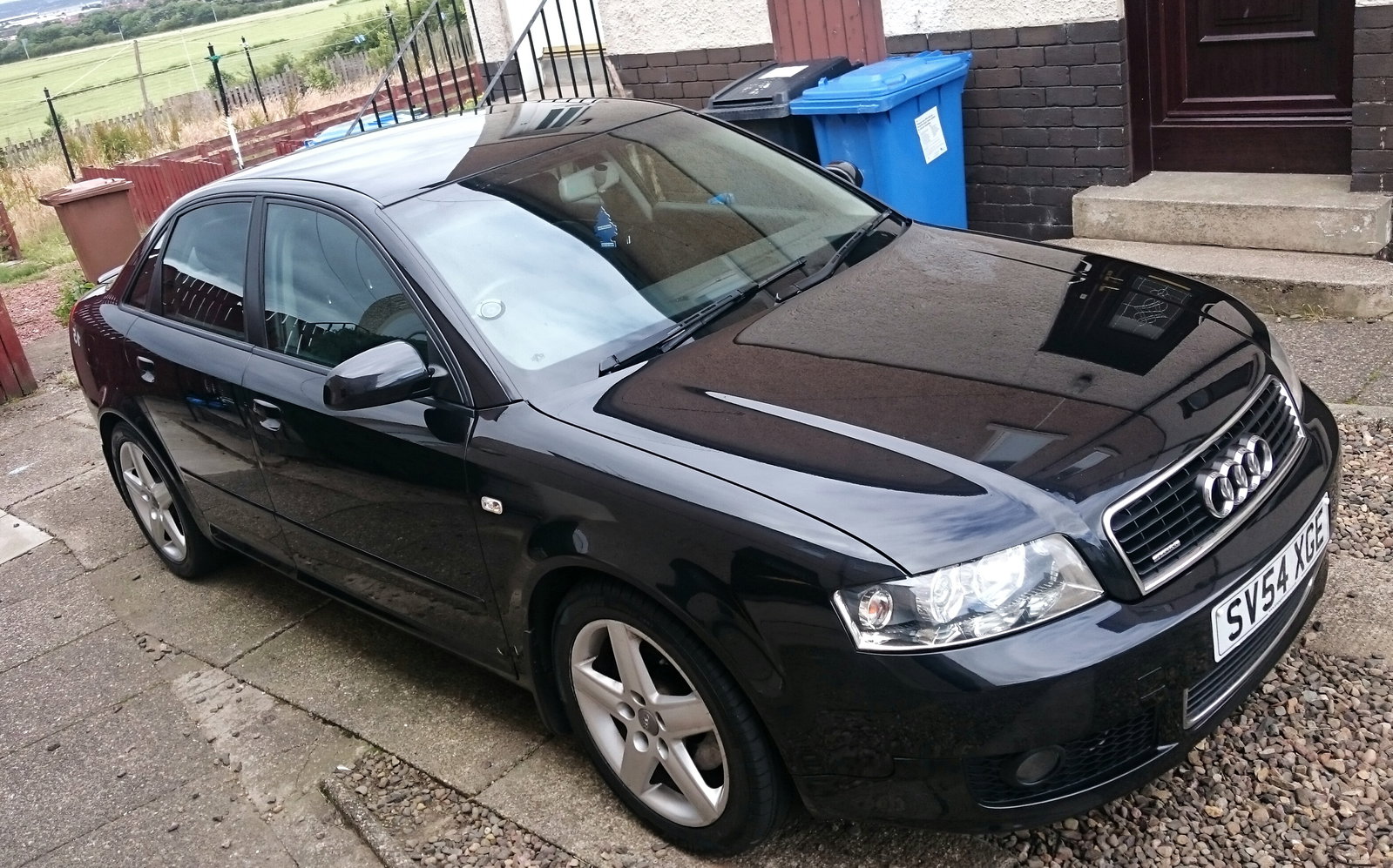

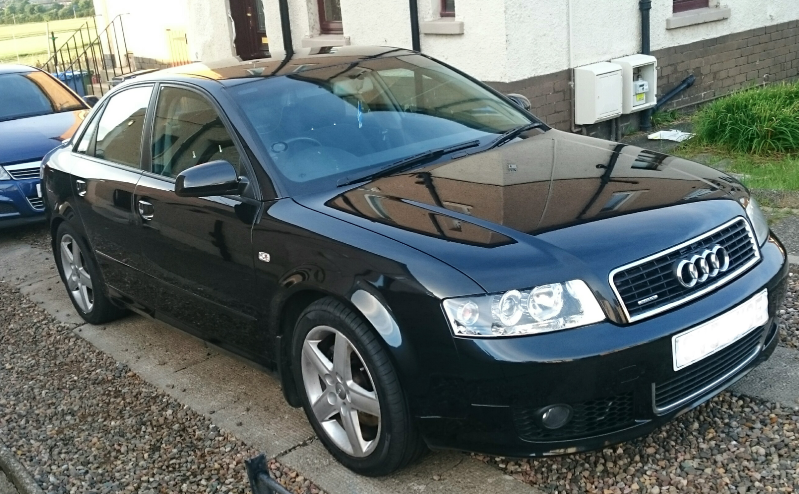

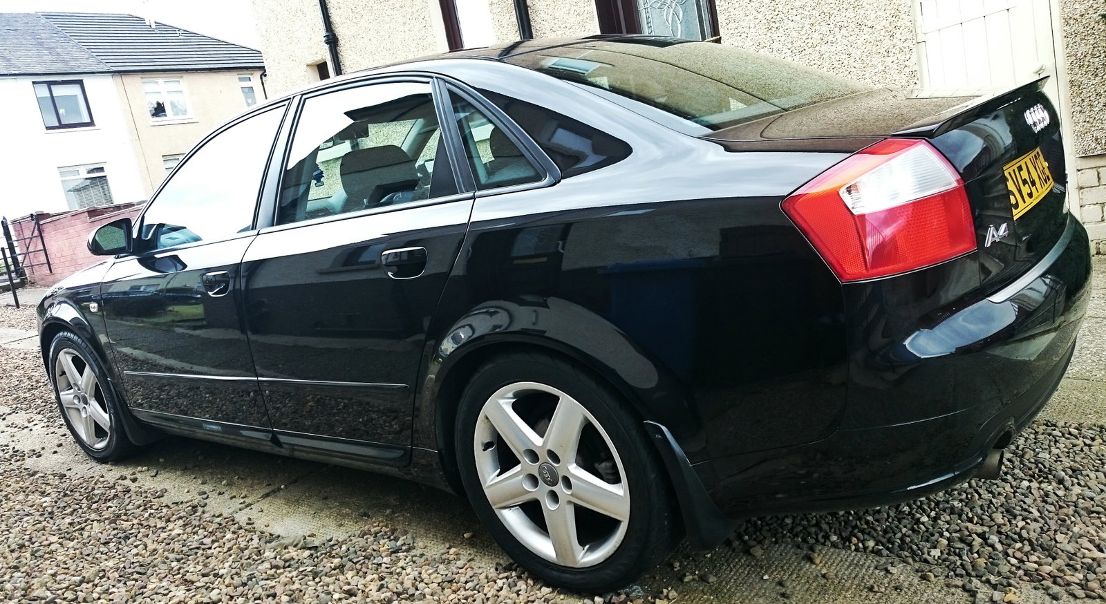

BigTazScotland Posted July 24, 2016 Author Posted July 24, 2016 Car goes in to Audi on Wednesday to change the sensor so I will let you know. Got it back today after the garage used M10 bolts on the suspension collar instead of hardened pinch bolts then had to Polish it again to clean the oil finger prints of it. Looking good if I say so myself
