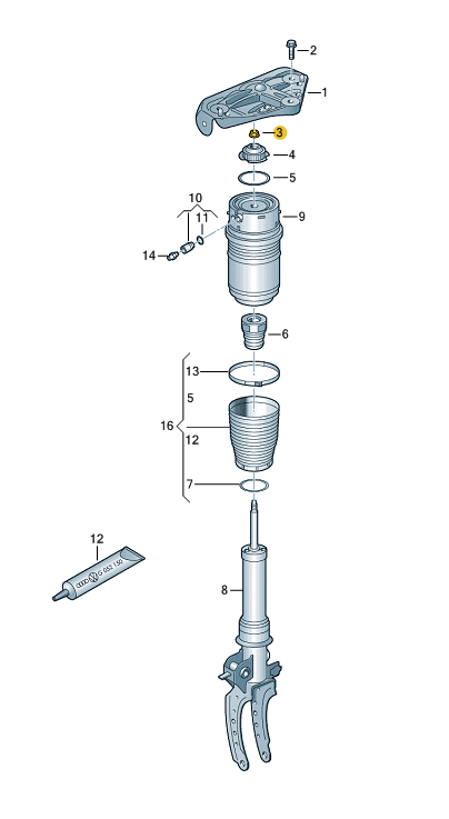

Bigdave1230 Posted November 6, 2016 Posted November 6, 2016 Hi all I have a 2006 3.0tdi Q7 which has developed a fault on the drivers side front suspension in that it goes down over night. Having raised the car up and squirted soapy water anti the strut/airbag etc, the place the bubbles are apparent is at the top of the strut where the cradle seems to sit just above where the air pipe connects. My question is does anybody know if there is some sort of rubber seal there or is it a sealed unit and I need a new strut. Any advise would be greatly appreciated as if it's just a case of a new seal at cost of a few pounds rather than a complete suspension strut.

Bigdave1230 Posted December 11, 2016 Author Posted December 11, 2016 Audi do sell the seals separately. It's a rubber o ring and costs £4.80 plus vat. Parts guy told me it's very common that the seal is at fault but because of the labour involved they only recommend replacing the entire unit to their customers which including fitting is over £1000. Replaced the seal and the car has stayed up over night ever since 1

Bigdave1230 Posted March 4, 2017 Author Posted March 4, 2017 Hi Andy it wasn't that hard really but just a little time consuming. It took a couple of hours. Got a squeezey bottle with a little washing up liquid and water in and then raised the suspension and squirted it onto the bag and cradle to see where the leak was. It was right at the top of the suspension cradle so wasn't the bag that was leaking. After removing the suspension strut the top cradle is held on with 3 13mm bolts. The seal is under that and is really easy to see and remove. I put a little sealer on the new one just to make sure it sealed properly. To remove the bag in case that's what is faulty on yours it looked like a nut in the centre under the cradle would need taking off to allow it to slid off. It was all fairly straight forward and obvious what needed taking off I wouldn't be worried about carrying it out as long as you have a good selection of tools. I used my mates garage and his air tools. I also replaced the pump on mine which was on its way out which was under the car on the drivers side. All the pipes for each corner of the car run from there so if you can't see any bubbles from your suspension have a look there as if it can leak on that connection too and have the same result. 1
