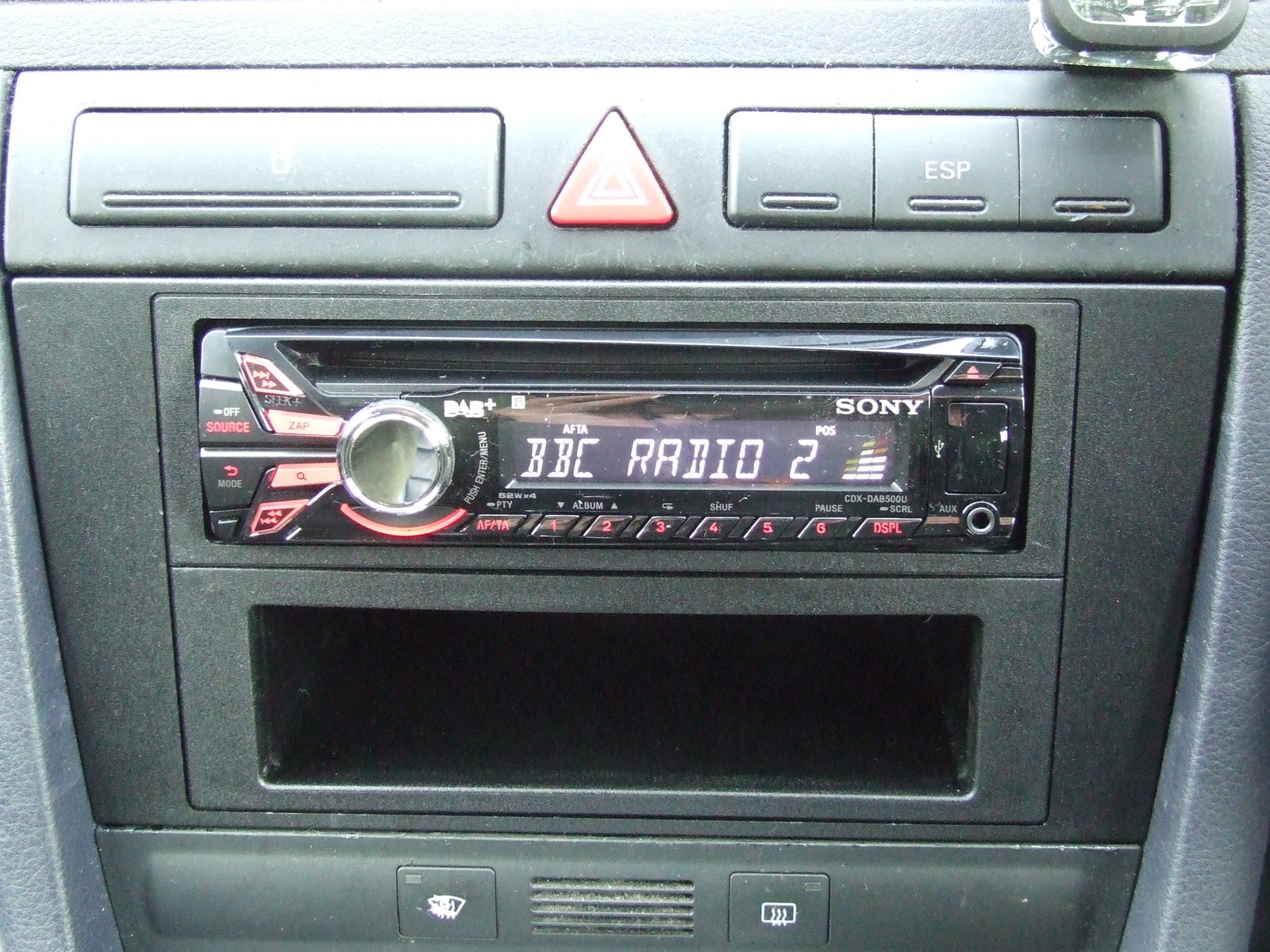

WelshSue Posted February 25, 2017 Author Posted February 25, 2017 Thanks Bradley for your reply. You obviously read my mind. As I was doing some searches on the net & found a lot of Owners have replaced their Head units. Hubby & I decided this might be the best option as a new diversity unit we have been told is over £100( don't fancy throwing money at a 2nd hand one as no guarantee it wouldn't have the same problem) & with, like you said DAB on the increase. Also the LCD display on the Symphony has a couple of lines missing. Time for a complete change. We are going to buy a new Pioneer DAB head unit with CD(will miss the 6 CD option though),wiring Harness adaptor, single DIN Fascia Kit & a amplified DAB/FM Roof aerial (to bypass the diversity system entirely). See below http://www.ebay.co.uk/itm/182235565439 http://www.ebay.co.uk/itm/250704951231 http://www.ebay.co.uk/itm/351781511371 http://www.ebay.co.uk/itm/400872415168 Didn't go with the Pioneer unit in the end, as a friend offered me a Brand new Sony CDX500U for £40 which come with a remote control. All fitted & looks good & more importantly no signal loss. I have done a "Word" document on how it was fitted & parts used. I will see if I can upload it on to here.
