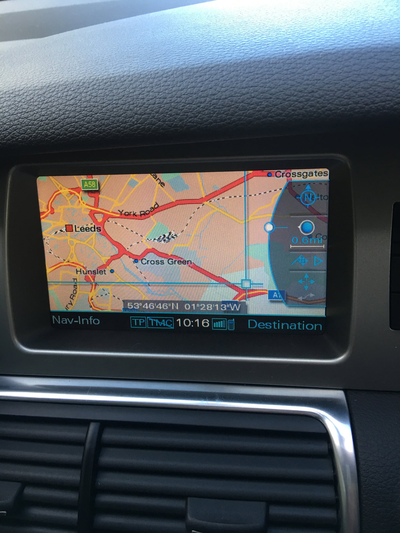

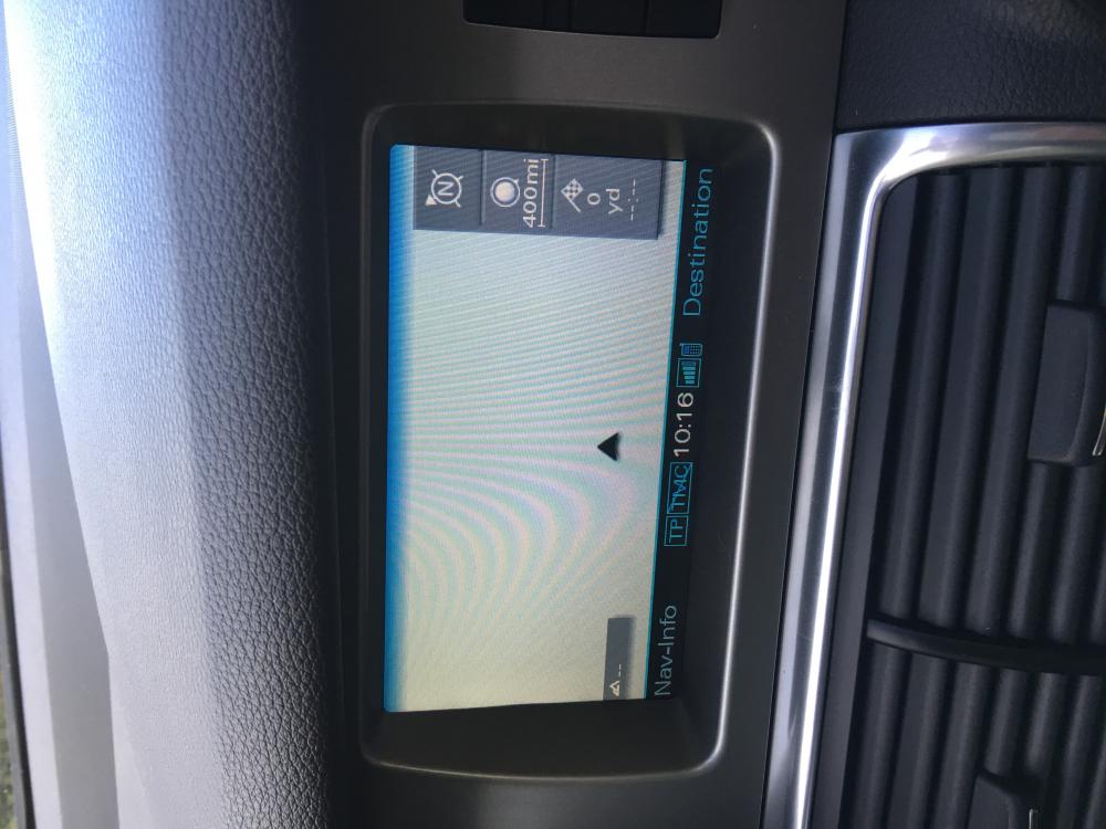

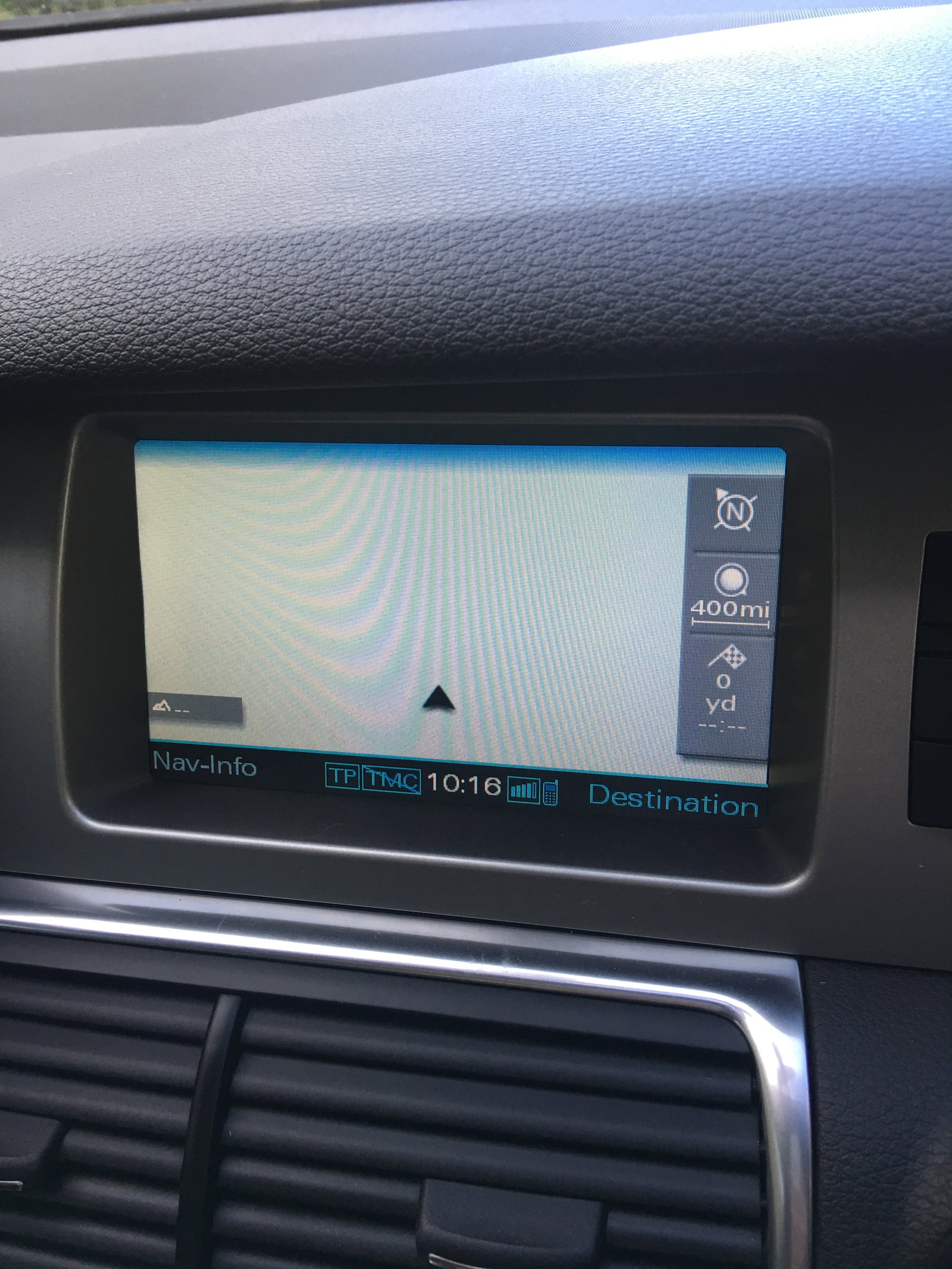

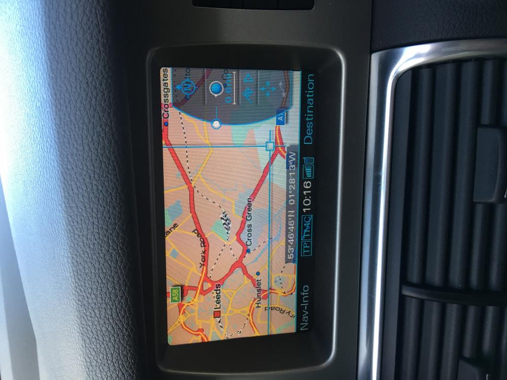

Bigdave1230 Posted January 29, 2017 Posted January 29, 2017 my sat nav has a white screen but all the key on the right had side. I purchased another disc thinking that it couldn't read the map information. When putting the new disc in the mmi says updating and has the % counting up then comes back on with the white screen. Having fiddled around in the manual position option it appears that my sat nav thinks I'm in Africa or somewhere similar so moving the position towards Europe shows my map. It will let you zoom in etc and has all the street names but when you press return it goes white again. Is there a way to tell it where you are to begin with? Could this be the gps antenna isn't working? If so does anybody know where it plugs in or if there is a module for it. The disc wasn't in when I purchased the vehicle as the dealer says they take them out and put them with the service books to stop them being stolen. Vagcom shows nothing related to the sat nav faulty. Cheers dave

Bigdave1230 Posted January 30, 2017 Author Posted January 30, 2017 I've enabled the hidden green menu on the mmi and checked the nav section which says it's not receiving any satellites so believe it's going to be something to do with the shark fin antenna but have no idea where it plugs in or how to check it other than making sure it's plugged in
Audi Owners Club. Posted January 30, 2017 Posted January 30, 2017 It does sound like a case of the latter....physically checking it's plugged in I would say. Can't think how it could go faulty as it's only an aerial, unless it has some base loaded circuitry Keep us updated Cheers Trevor
