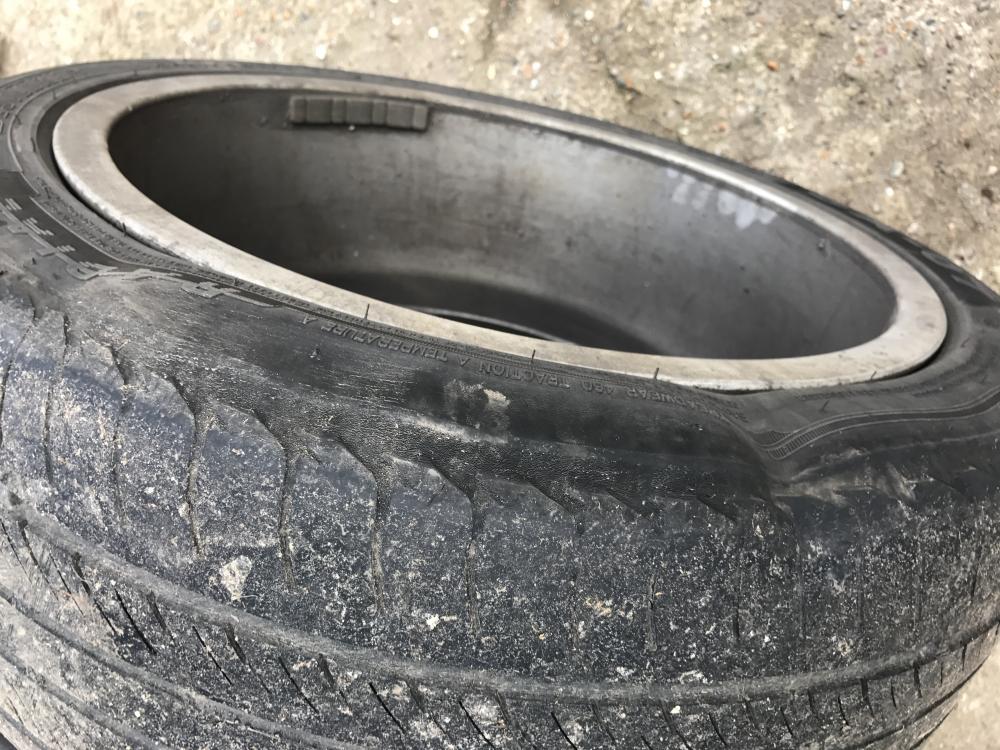

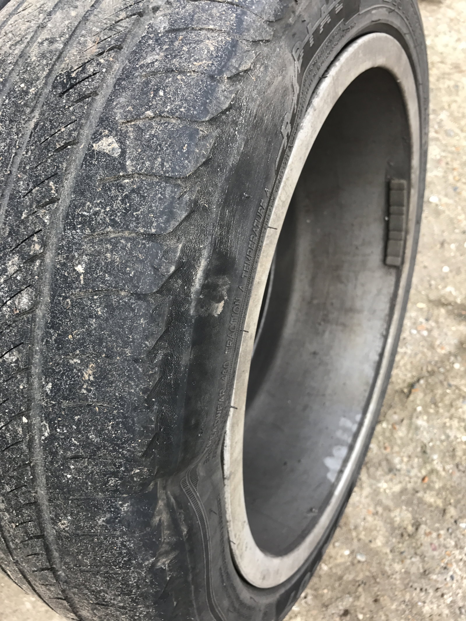

rbdazza Posted February 20, 2017 Author Posted February 20, 2017 Kind of ties in with having my tyre replaced saturday
rbdazza Posted February 20, 2017 Author Posted February 20, 2017 Oh yeah, on that tyre. Happy frickin birthday to me lol 1
Audi Owners Club. Posted February 21, 2017 Posted February 21, 2017 ooh...I wouldn't want to be standing next to that when it pops! That's definitely your reason for the vibration then

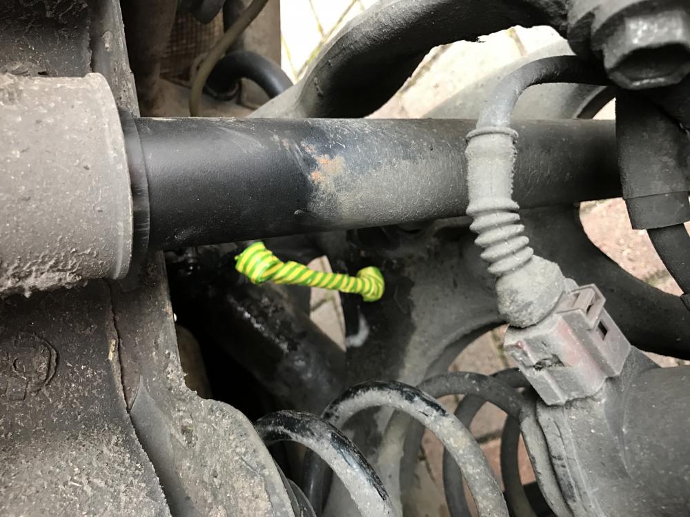

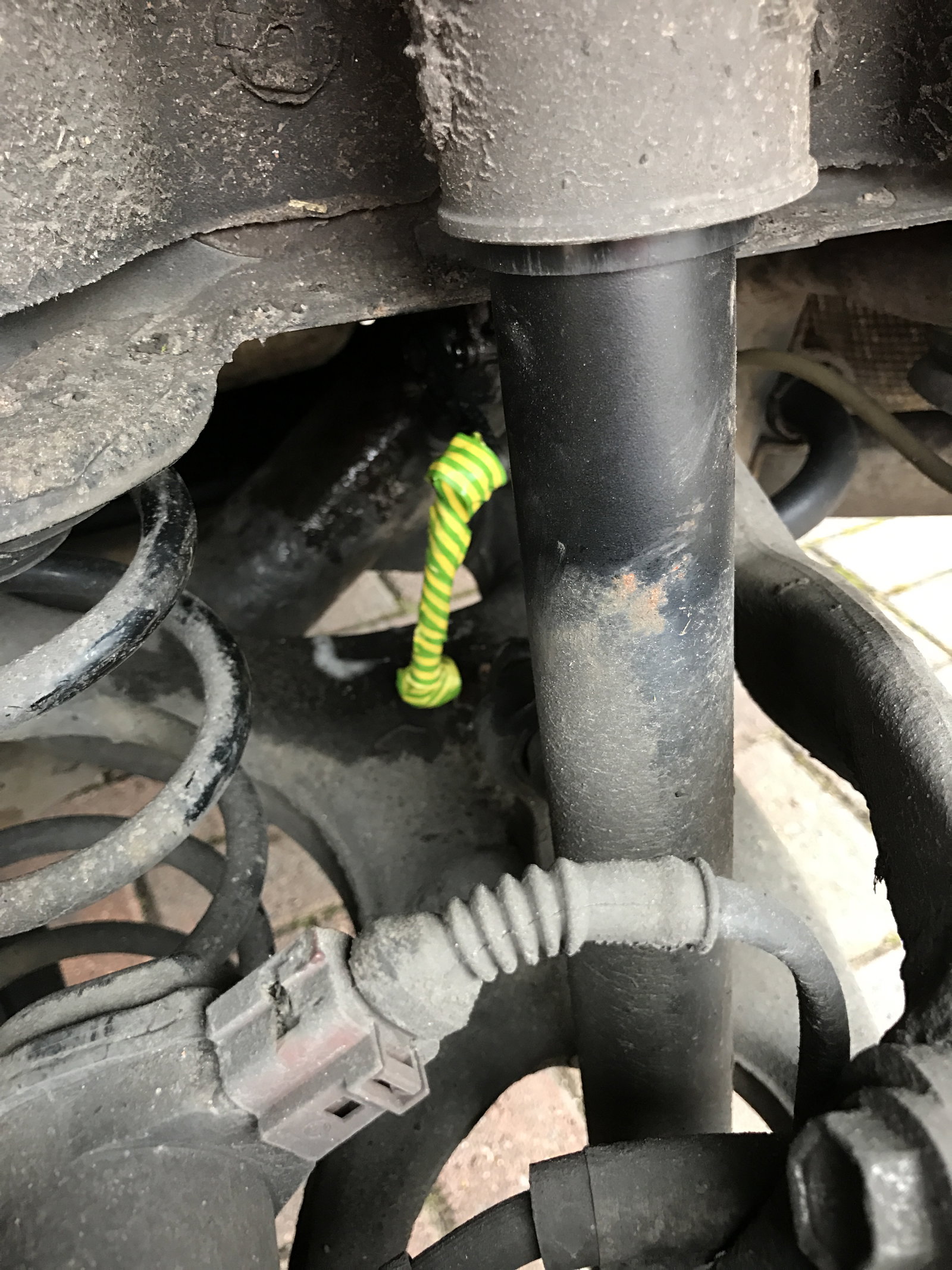

rbdazza Posted February 21, 2017 Author Posted February 21, 2017 indeed lol, not good eh. ah well that corner now has a nice fresh continental boot! i have got to the bottom of my headlight issue. the levelling sensor has broke, a small bit of plastic on the bracket! phoned TPS, £130 for a replacement part would you believe!! Currently looking for a decent used part on eBay, they seem to be around £30 on there but i need to find one in decent nick and make sure i grease it up good to stop the tension breaking it again! in the meantime, being the frugal sole i am, i've bodged it!
rbdazza Posted February 21, 2017 Author Posted February 21, 2017 I know you all want to see my 5 minute bodge haha 1
Audi Owners Club. Posted February 21, 2017 Posted February 21, 2017 Don't like the word 'bodge' .... prefer to call it 'adaptive engineering'
rbdazza Posted February 21, 2017 Author Posted February 21, 2017 yes that sounds much better! i even used the 'Earth' insulation tape so it is easier to see if it breaks away, not because i couldn't be bothered hunting out the black roll... 1
Audi Owners Club. Posted February 22, 2017 Posted February 22, 2017 That's quite a considerable difference...just hope the tape holds out
