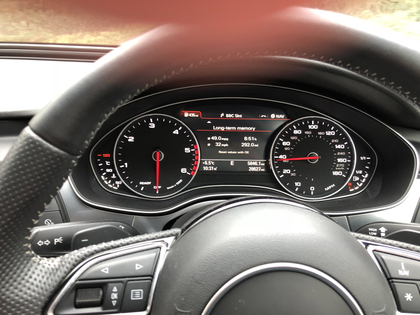

Envy Posted January 23, 2018 Posted January 23, 2018 Hi Jenny: As you can see - no-one has really come back to the forum with any information / progress regarding this possible issue with their car. When the engine cuts out (stalling is caused by overloading) can you recall what you were doing regarding controls input. Throttle on / throttle off. Braking? I see you have your drive selector in economy - is this always the case or just in the picture? Mine will stop its engine coasting up to stopped traffic but not above 10MPH. When it cuts out does the rev counter go to "ready" or "off"? If we can find a common factor when the issue occurs this will be of use to any mechanic trying to diagnose the issue. My best advice is to keep on to Audi regarding the matter - you are approaching the end of normal warranty for the Car - this should be sorted as part of that original manufacturers cover.
Jennyhen777 Posted January 23, 2018 Posted January 23, 2018 Hi Tom, Many thanks for replying. The car has reasonable heating controls on at the time of happening as well as the radio but that is about it. It seems to happen when throttle off but not sure if coasting has been engaged as all of a sudden the warning sound/message comes up with manual restart required. The rev counter goes to Off as in the picture and yes I do have it in Economy mode at all times. It's happened 3 times at this speed over the course of 4 months which makes it extremely hard to find the fault as it's so inconsistent, therefore the dealership couldn't find anything wrong the first time but they are having it back again. I've got one year of the warranty left as was registered in 2016 so I'll certainly be continuing to get this sorted as it could be very dangerous.
Envy Posted January 23, 2018 Posted January 23, 2018 Hmm - with the car in Economy (Efficiency) mode, when you throttle off the car goes into coast mode effectively putting the gearbox into neutral allowing the car to free wheel at what should be tick over engine speed. With the gearbox in neutral there is no drive back through the geartrain from the wheels to maintain engine idle. This could be where the issue sits. If it were me with the Audi overalls on I would be looking at sensors and settings around engine idle control. The next question would be does the fault happen in Auto drive mode? I tried all drive modes when I first got mine and it sits in Auto Drive Select most of the time now with no perceivable difference in economy. I concede this is not a fix but could be a work around of sorts 1
Jennyhen777 Posted January 23, 2018 Posted January 23, 2018 I'll certainly pass that on but I'm not sure whether the coasting function has cut in by that point or if I have braked at all then the coasting function wouldn't activate any way. All these times were completely unexpected and therefore not really paying much attention unfortunately but as I do now, chances are that it won't happen again. I've tried switching off the auto stop/start in case that has anything to do with it but haven't tried Auto mode yet. I fear that as it is so sporadic and rare, it will take me a very long time to be able to tease these things apart and I don't want to be in an accident as a result of it. If they can't find a problem then they can have the car back.
