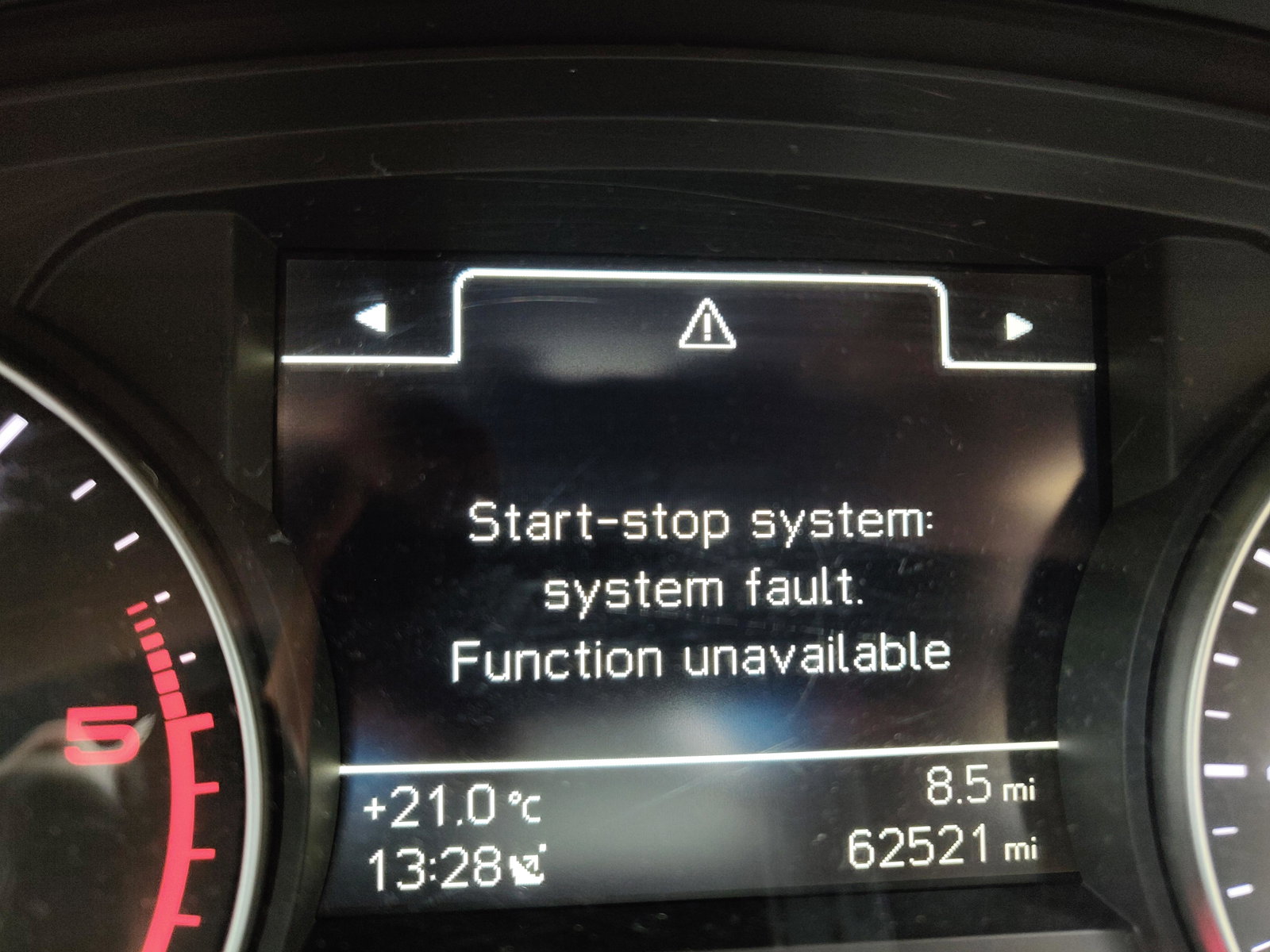

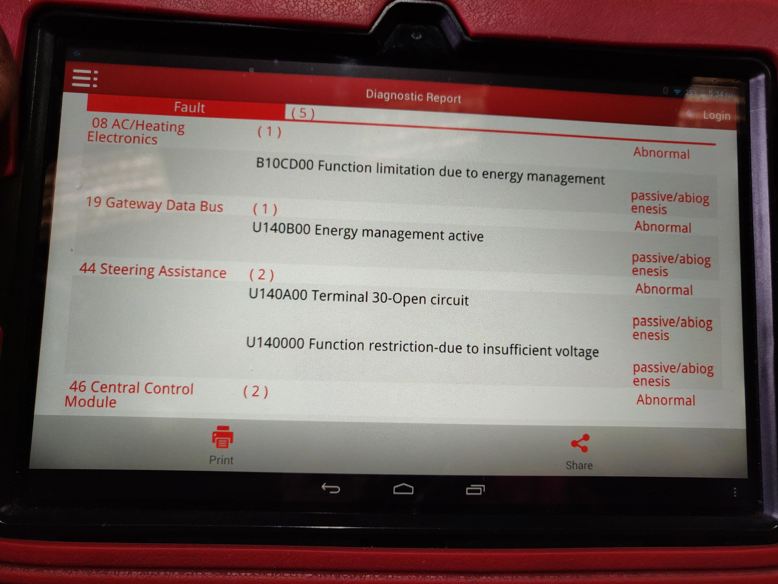

Jatman Posted October 19, 2021 Posted October 19, 2021 (edited) Hello All, I have an 2014 Audi A6 with exactly the same issue. I took my car to kwick-fit to test the battery, the readings were all clear. Then I took the car for a service / MOT at a separate garage and ran an electronic test, they found a few error messages on the computer. When I was holiday, the cars power closed down, literally had no power, no electronics, had to open my drivers door to activate the electronics, pressed start / stop and the car restarted. Today when to school at 16:20, parked up, the cars whole power system shut down. Couldn't power on, no lights, couldn't lock the car, zilch. Went into school, got the kids, they had to climb through the drivers door as there was no power to the car. Waited till 17:00 till power reset itself in the car. Then drove home. So in mine the start / stop system shuts down the whole electrics to the car. I have the car set to dynamic mode, the issue happens at low revs. It's hard to replicate as it's random, but my does shut down and I can't restart all the time, making it dangerous to sit in. Need help fast please. Thanks. Edited October 19, 2021 by Jatman
Magnet Posted October 20, 2021 Posted October 20, 2021 Hello Jatin, My money would be on an unserviceable battery - despite what Kwik Fit tell you. I’m pretty certain your car is fitted with a Battery Condition Monitor (BCM) and this is continually monitoring all parameters of the battery’s efficiency and will start to shut down various features, as the battery becomes deficient in any monitored parameter. Probably, Kwik Fit’s test was a basic check. The batteries on Stop/Start equipped vehicles obviously get a hammering, and can deteriorate at a rate of knots. Your car is 7 years old, and it would be surprising if the original battery has lasted that long, and not impossible that it has already been replaced, and that one is now failing. What make battery is fitted to the car Jatin? That should give you an indication of whether it is the original or not. A couple of points, if you do decide to renew the battery:- Buy once and wisely, and certainly not on price. I buy Varta/Bosch ( their 4 or 5 year warranty variant) from specialist on-line battery suppliers such as Battery Megastore or Tayna ( there are more - search eBay for best deals on these). Double check the correct battery you need by giving the supplier your registration number. It is highly likely that the new battery will need to be coded to the car - otherwIse the system will assume it’s still the old battery. Kind regards, Gareth.
Anton8 Posted October 20, 2021 Posted October 20, 2021 Hi I thought the stop/start function was run using a large capacitor, which is recharged via the alternator using engine power. I didn't think the battery was involved in this function. This is why the stop/start seems to be random because it relies on the charge in the capacitor not the battery. Perhaps the capacitor should be looked at. Tony
Stevey Y Posted October 20, 2021 Posted October 20, 2021 Hi possibly the BEM module gone up the wall its a fairly simple task but I believe a new one will need re coding, have you had your car scanned for faults?. Steve.
