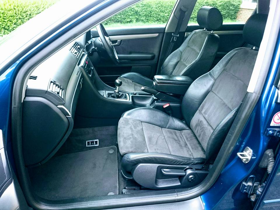

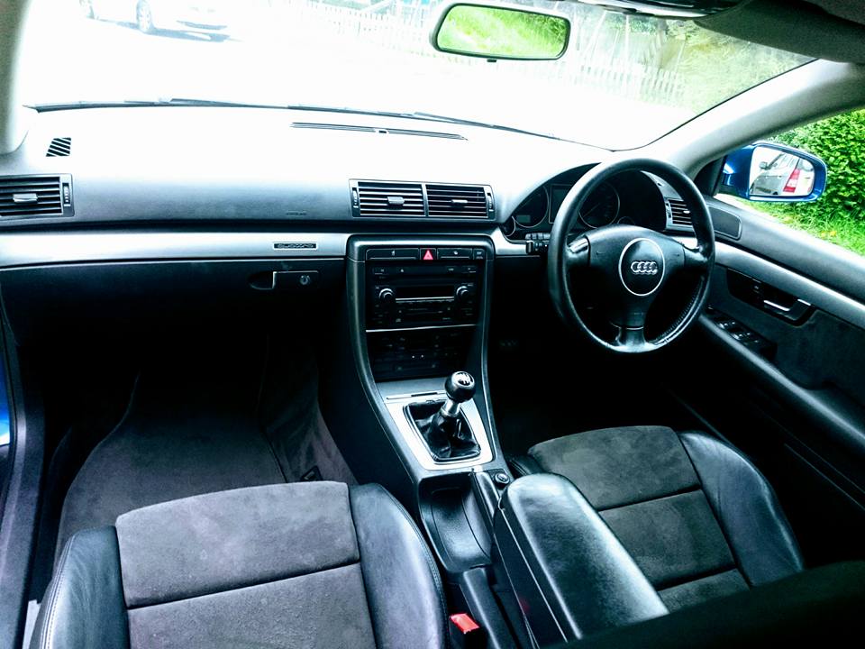

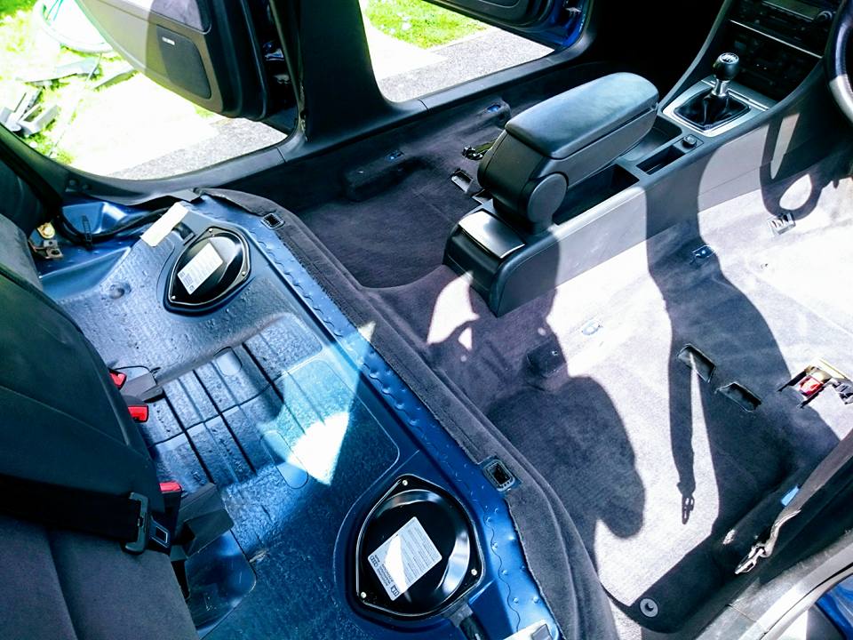

I bought this car on Friday so only had it a few days now, today was the first time I had a chance to get stuck in so I decided to tackle the interior. It wasn't tired by any means it just hadn't had a good old clean for a while. So I took the seats out, gave everything a good wipe down and general clean and replaced them once complete. Pics to follow. I haven't tackled the exterior as yet but can't wait to as it's in fantastic condition and think it will come up really well...

She looks really straight on the outside and just run in on the inside. What a nice car.
