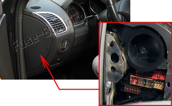

Lionbeast Posted April 6, 2021 Posted April 6, 2021 On 4/5/2021 at 9:26 PM, gently said: Parking Heater It was my aux heater that was the problem. Pulled the a5 fuse on the driver side location. And it stopped. Atleast now it is not draining the battery. Will look into to it further. What is causing to go bananas. Thanks for the help. 1
Olli Posted April 14, 2022 Posted April 14, 2022 I had exactly this problem with my 2012 Q7 TDI and removing the fuse stopped it. Thanks a lot for the hint. Now need to get the aux heater fixed but luckily summer is coming so likely not urgent.
