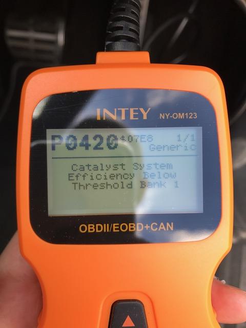

GraemeB Posted June 3, 2017 Author Posted June 3, 2017 So, here's a quick update. Welcome any one else's thoughts / experiences on this. - Didn't bother with the cleaner; reviews online were less than convincing. - I've since had both the sensors replaced. Expensive job at roughly £500 for the pair. - After 400 miles, the EML has come back on again - though this time i've now got my own code reader. - Just spoken to a mechanic; he's advised me that it's a dealer only part (the cat) He also said a few other things, as follows: - Do some research online; consider cutting out the cat altogether and having the ecu re-mapped - Speak to a dealer; this may also be a software glitch (nice of him to tell me that after i've just paid for the sensors to be replaced) - I'd also spoken to someone else who advised on alternative methods of sorting my CAT So, to summarise. I'm no further forward; just £500 worse off :-( Any tips from anyone??
