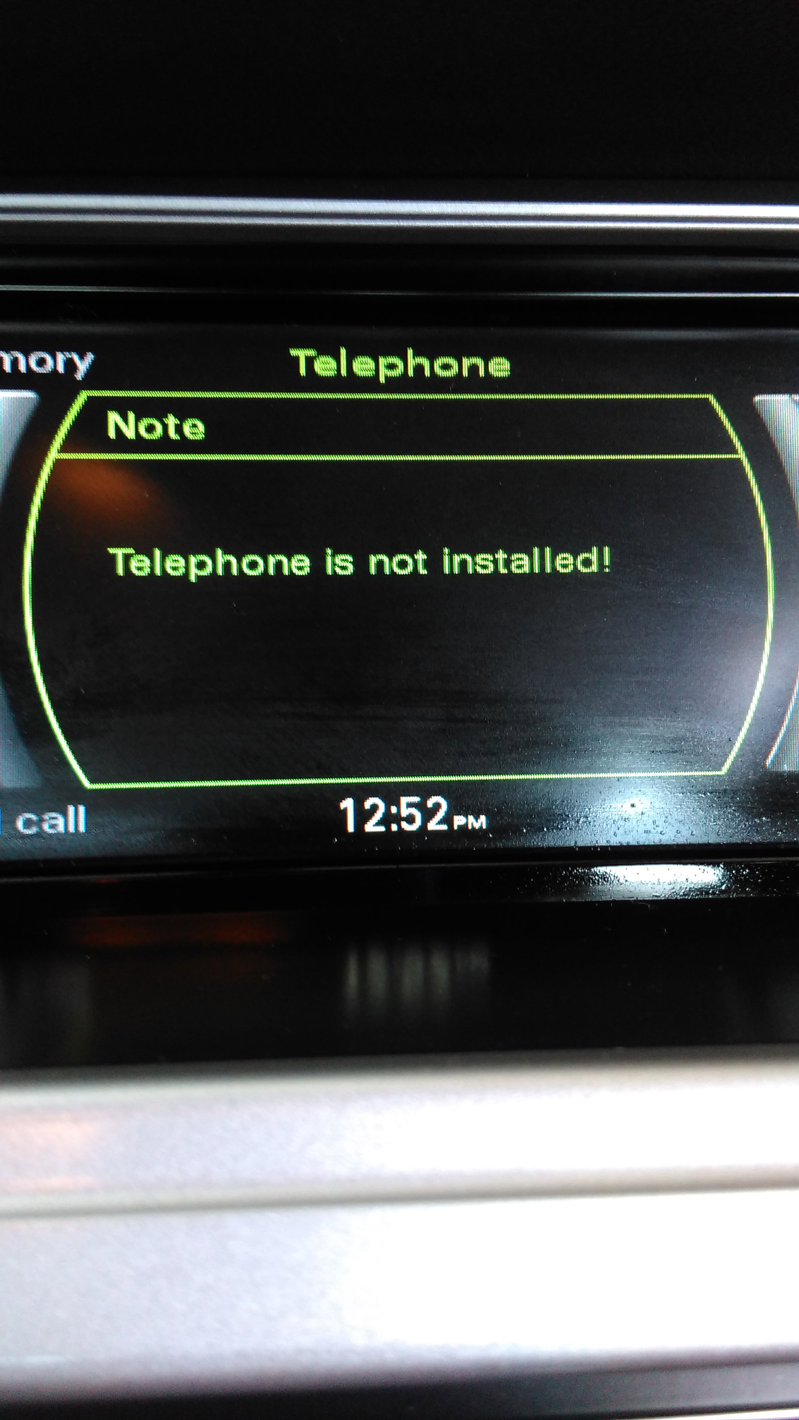

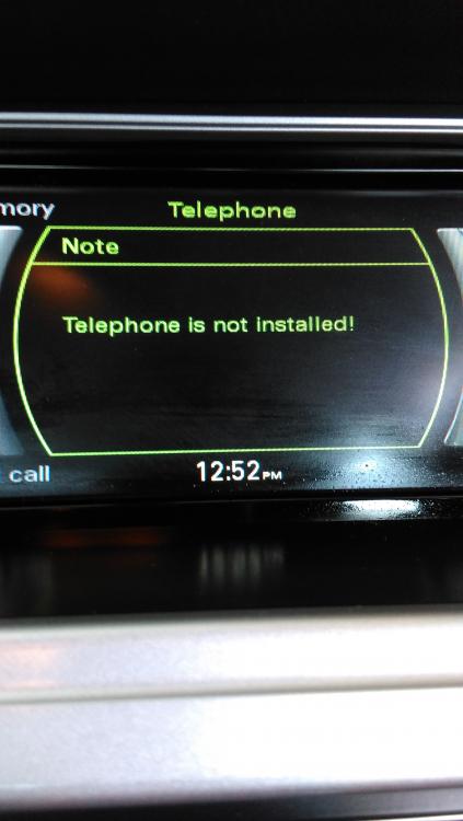

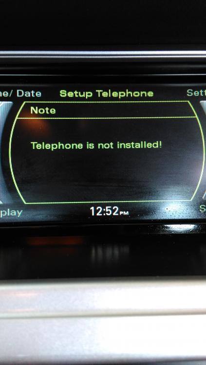

Greg71 Posted May 12, 2017 Share Posted May 12, 2017 Hi again everyone, I've just picked up my 08 Audi A4 2.0TDI SE, and I cant get mine or my wife's android smartphone to connect to the MMI using Bluetooth. I push the phone button, and get this message, Then if I push the settings button, I get this message, I have tried plugging it into the AUX socket in the centre console, but still nothing. The method I have used is ;- unlock and get in car, turn ignition on, press phone button, search with my phone for Audi via my Bluetooth, it finds other things but not the car. any suggestions would be gratefully received. thanks in advance. Quote Link to comment Share on other sites More sharing options...
