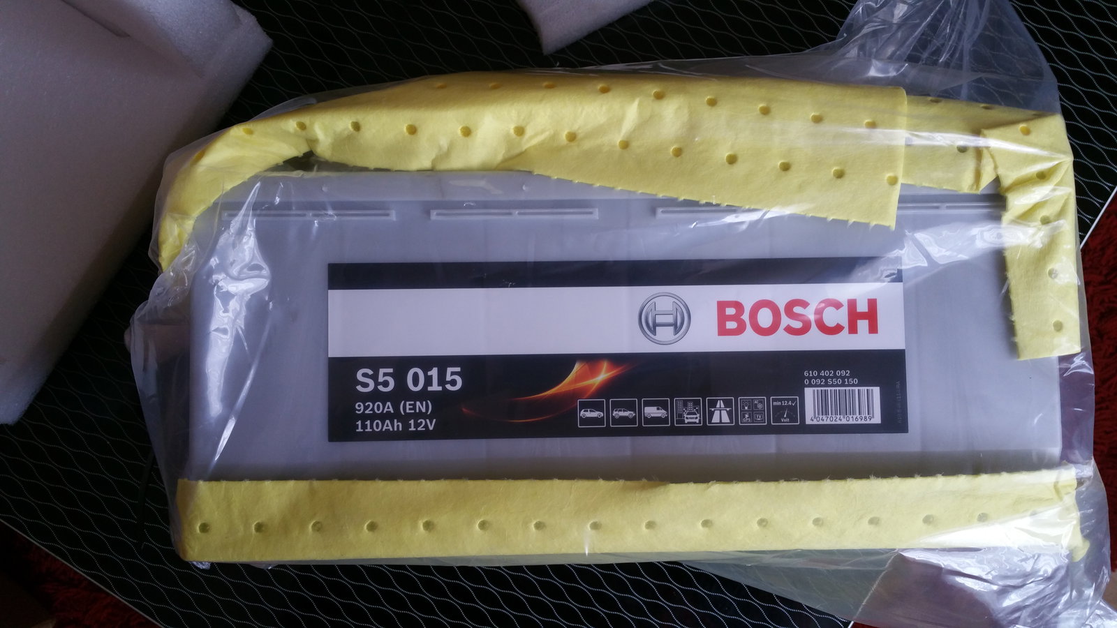

Luey Posted October 7, 2017 Posted October 7, 2017 Sorry I mean't to reply sooner. It's been a very busy 24 hours. I did some checking yesterday for you. The LION battery you have currently fitted is up to the minimum specification recommended by the manufacturer, however they are a cheap alternative. The BOSCH battery you just bought is perfect! It's got a few extra cranking amps and a little more power too and it'll be very well manufactured. I'm still betting the battery has died personally. It was probably poorly manufactured or something. Hopefully you can return for a refund if it had died already. Again whatever is wrong it absolutely can't be anything major. My Audi was poorly cared for by it's last owner, I like to think I rescued her, she'd done 29,000 miles without a service. She required a little love and attention but she's not let me down yet and every time I drive her I've had the biggest smile on my face. I've done most of the work myself using a £25 tool kit bought many many years ago from Aldi. Audi built fantastic cars, and they build them well, but as with any car they can have a problem every now and then. The only new thing I can think of you might want to check is the fans on the radiator. After you've been for a drive shut the car off and give it a minute or two, then go open the hood and directly beneath you will be the radiator. The radiator will have a couple of electric fans connected to it, see if they're still spinning, the circuit to them can breakdown and get stuck on which drains the battery. They might/should run for a little while after you shut the engine off to cool it down. However if they're stuck on after say 5-10 mins something may be wrong. It only takes a couple minutes to check and it doesn't cost you a penny.

Moe Posted October 7, 2017 Posted October 7, 2017 1 hour ago, Luey said: Sorry I mean't to reply sooner. It's been a very busy 24 hours. I did some checking yesterday for you. The LION battery you have currently fitted is up to the minimum specification recommended by the manufacturer, however they are a cheap alternative. The BOSCH battery you just bought is perfect! It's got a few extra cranking amps and a little more power too and it'll be very well manufactured. I'm still betting the battery has died personally. It was probably poorly manufactured or something. Hopefully you can return for a refund if it had died already. Again whatever is wrong it absolutely can't be anything major. My Audi was poorly cared for by it's last owner, I like to think I rescued her, she'd done 29,000 miles without a service. She required a little love and attention but she's not let me down yet and every time I drive her I've had the biggest smile on my face. I've done most of the work myself using a £25 tool kit bought many many years ago from Aldi. Audi built fantastic cars, and they build them well, but as with any car they can have a problem every now and then. The only new thing I can think of you might want to check is the fans on the radiator. After you've been for a drive shut the car off and give it a minute or two, then go open the hood and directly beneath you will be the radiator. The radiator will have a couple of electric fans connected to it, see if they're still spinning, the circuit to them can breakdown and get stuck on which drains the battery. They might/should run for a little while after you shut the engine off to cool it down. However if they're stuck on after say 5-10 mins something may be wrong. It only takes a couple minutes to check and it doesn't cost you a penny. Amazing ! Sounds very reasonable. Will so after I get someone to change the battery. Talking of battery, would changing it play up on the car memory? I've been told it could play up and then you will need some code for the radio. I just got back from the car after leaving it for a whole day. Won't lock or unlock via remote, so had to manually open driver side door. Sat inside and heard this eeeeeeeeee like sound. So I pressed the seat button randomly and held it, no response but the sound disappeared. When I let go of the button it reappears? Could that be the battery draining source or something? It's got me even more worried now.
