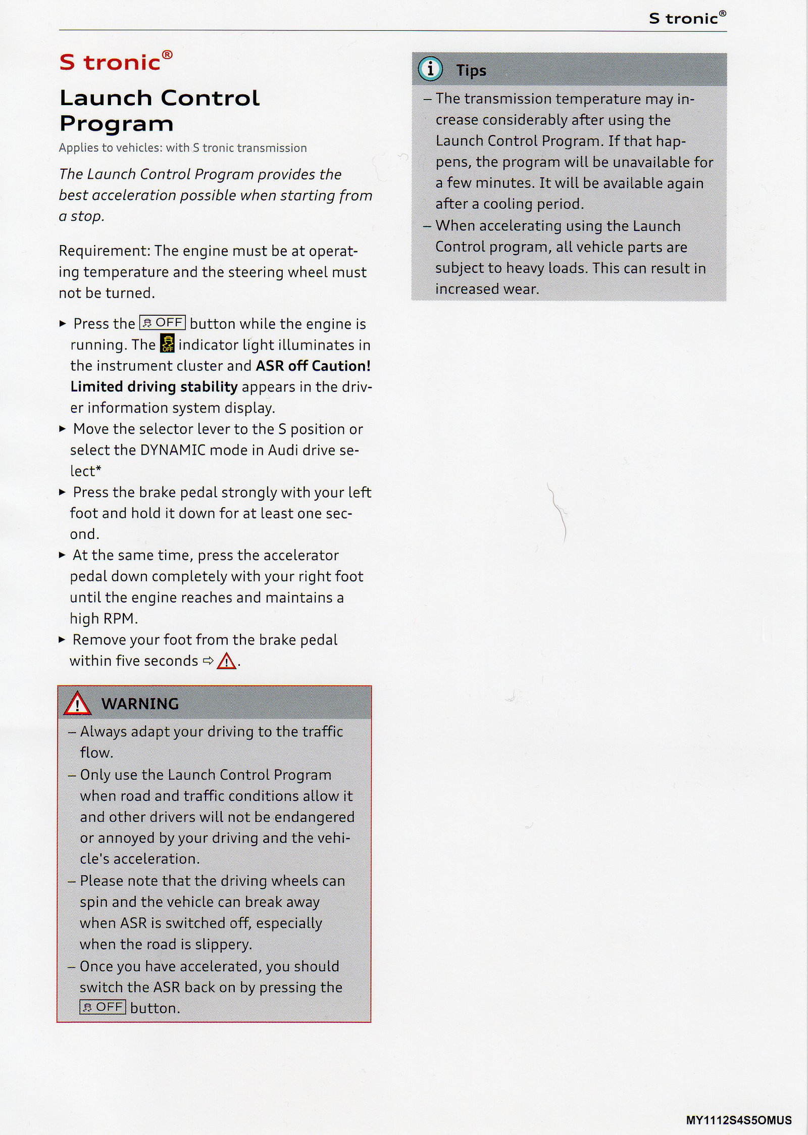

T77OMY Posted May 21, 2017 Share Posted May 21, 2017 My launch control doesn't work every time? Quote Link to comment Share on other sites More sharing options...
Luey Posted May 22, 2017 Share Posted May 22, 2017 I believe it should explain the workings of you launch control in the owners manual. However what you'll probably find is; launch control can be very stressful on the engine, gearbox and drive train. Audi program in safety features to prevent damage to the car. You will find launch control will not work unless certain criteria is met. If the engine/gearbox is too hot it will not launch until it's had time too cool down. If the engine hasn't warmed up to operating temperature it likely will not launch either. A lot of people don't realise frequent abuse of Launch Control can damage your engine. Same way a lot of people don't know you need to warm up a car, especially a turbo charged car, before you can safely put it through it's paces. You'll find most modern cars have these fail safes and it'll prevent you having very expensive bills further down the line. It should also state in your owners manual that launch control subjects your car to heavy stresses and can increase wear and if improperly used cause damage. + If you're ever in Sussex please feel free to take me for a drive in your S4 Edit: Some rumours also suggest there is a limit on how many times you can use launch control. If you go over the limit your warranty is no longer valid or launch control will stop working permanently. They say about 200 uses apparently. 1 Quote Link to comment Share on other sites More sharing options...
