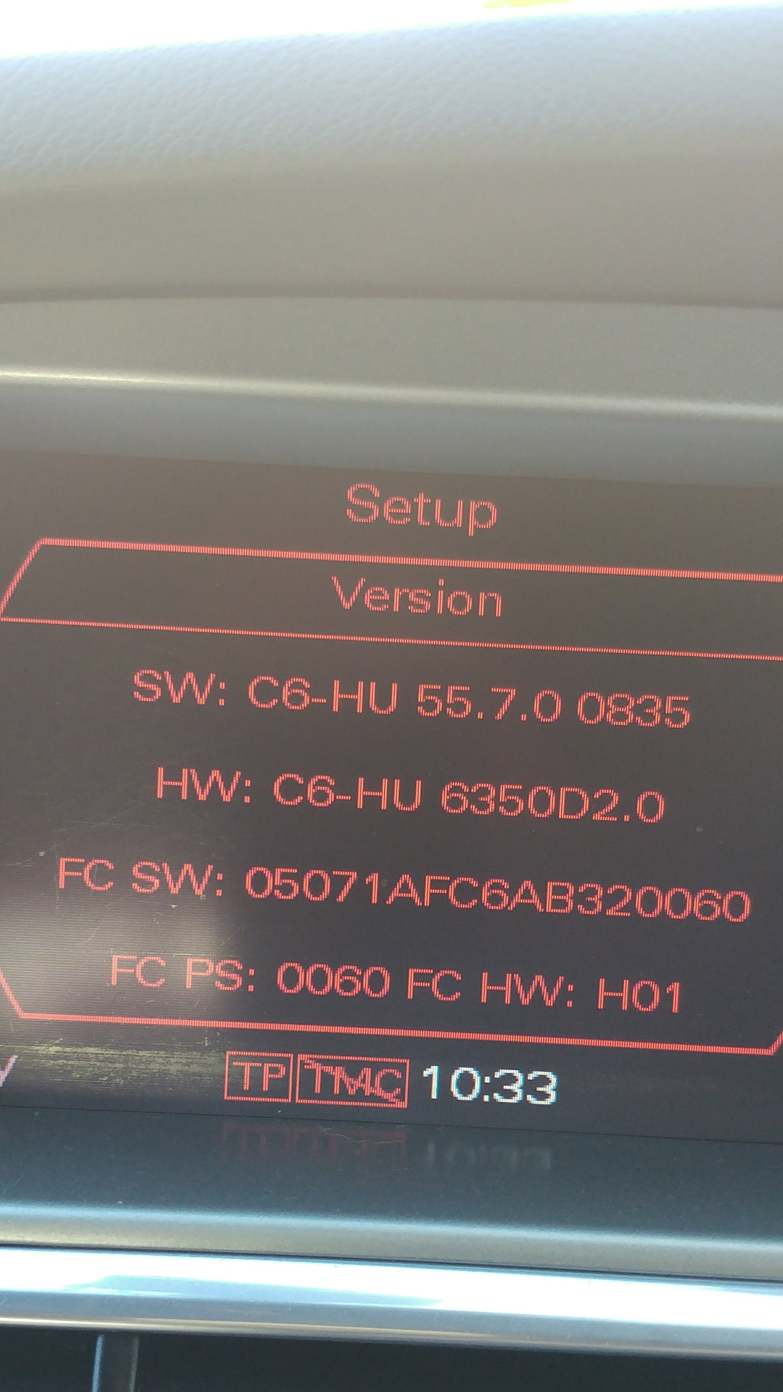

gsm6575 Posted July 17, 2017 Author Share Posted July 17, 2017 Thanks for the replies guys. Im not sure which version i have, i think its MMI 2G? Also it looks like i have SW version 5570 already. I've attached a pic of my settings, can someone confirm which i have please? Quote Link to comment Share on other sites More sharing options...
WPAWS Posted July 17, 2017 Share Posted July 17, 2017 31 minutes ago, gsm6575 said: Thanks for the replies guys. Im not sure which version i have, i think its MMI 2G? Also it looks like i have SW version 5570 already. I've attached a pic of my settings, can someone confirm which i have please? yep u do so go ahead and buy the dvd maps, link i showed has a buy now link i ordered the 2017 update and got it for £10 best offer try your luck m8 http://www.ebay.co.uk/itm/Audi-2017-MMI-2G-High-Navigation-Maps-UK-Europe-Sat-Nav-Disc-DVD-A4-A5-A6-A8-Q7/282558195952?ssPageName=STRK%3AMEBIDX%3AIT&_trksid=p2060353.m2749.l2649 Quote Link to comment Share on other sites More sharing options...
gsm6575 Posted July 25, 2017 Author Share Posted July 25, 2017 Thanks Paul, got it for £11 and all working.. Quote Link to comment Share on other sites More sharing options...
WPAWS Posted July 25, 2017 Share Posted July 25, 2017 6 minutes ago, gsm6575 said: Thanks Paul, got it for £11 and all working.. nice one m8 bargain price too Quote Link to comment Share on other sites More sharing options...

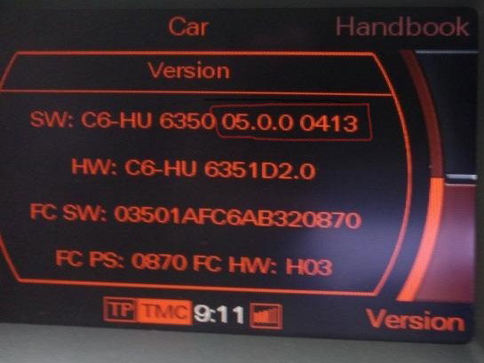

spottedhaggis Posted March 15, 2018 Share Posted March 15, 2018 I cant figure my version out. I have tried comparing it to others but I seem to have more numbers. I also purchased the 2017 dvd maps, will they work on mine or do I need to do an MMI update? Quote Link to comment Share on other sites More sharing options...
spottedhaggis Posted March 24, 2018 Share Posted March 24, 2018 ok so I went ahead and purchased the 2017 maps on eBay, and they installed and worked without any issues. Not sure, still what version MMI I have but I now have all the disks needed to go up to the latest verison Quote Link to comment Share on other sites More sharing options...
WPAWS Posted March 24, 2018 Share Posted March 24, 2018 i have red boxed ur current SW version and posted my current update SW so you will see it has changed once you update Quote Link to comment Share on other sites More sharing options...
spottedhaggis Posted March 24, 2018 Share Posted March 24, 2018 Thanks, now I understand it all better. My new 2017 sat nav disk from eBay seemed to work 100% even with my old 2004 version of software :-) Im still doing the update, tomorrow. I assume if I place a trickle charger on the batter while I do it, all will be ok? Quote Link to comment Share on other sites More sharing options...
