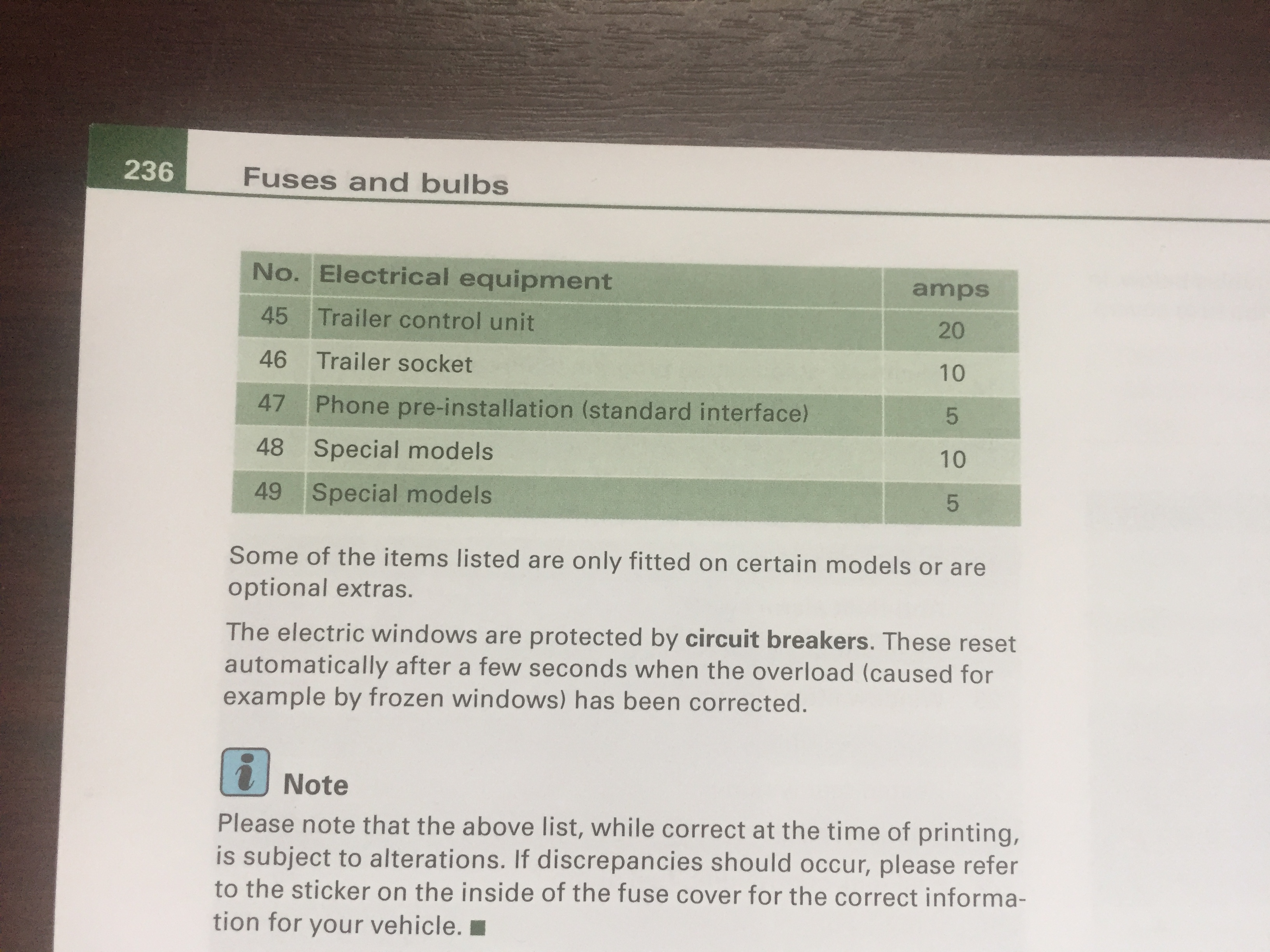

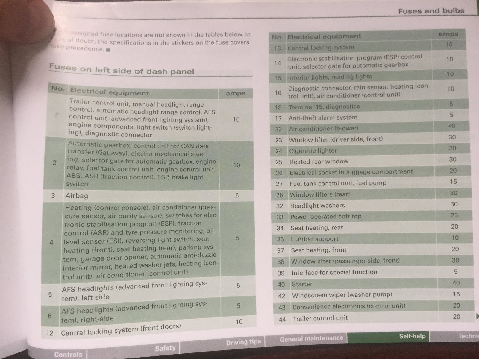

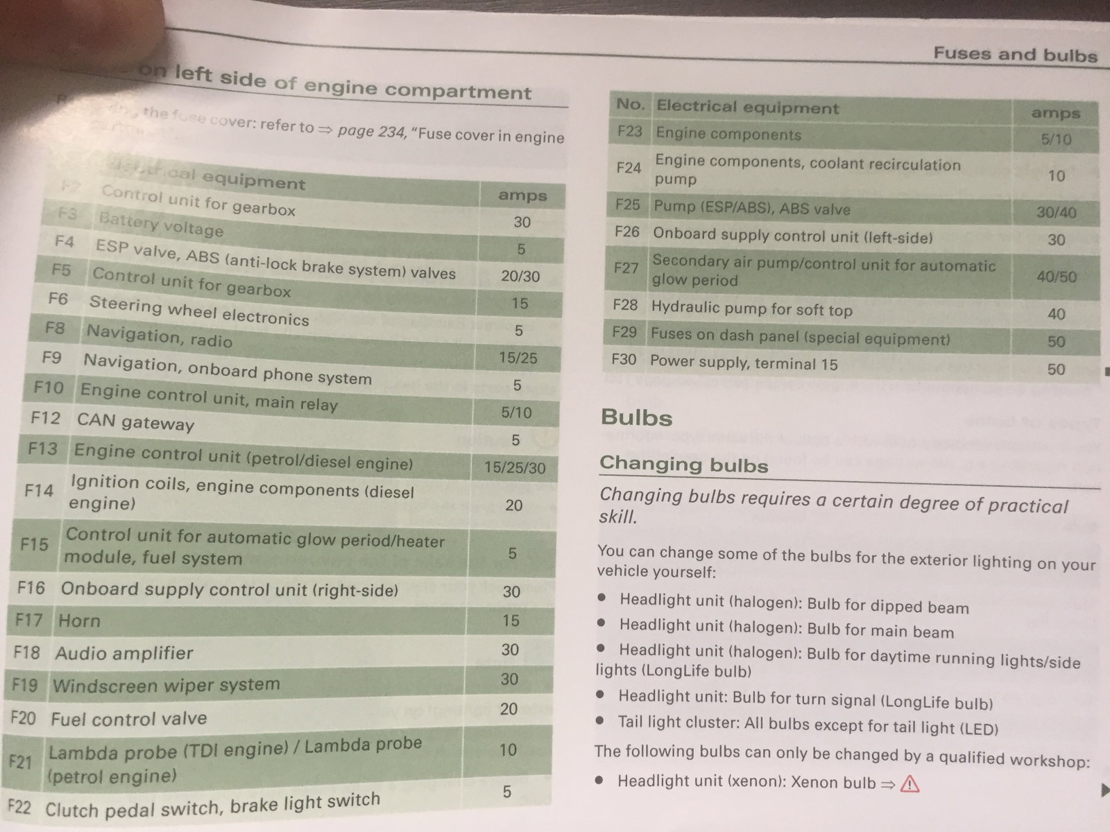

drewwwwwd Posted August 11, 2017 Share Posted August 11, 2017 Hi Folks, As of yesterday, my 2008 A3 Cabriolet warns me that the reverse lights, rear fog lights and number plate light are out of action. Also, the key fob won't open the boot. And every time I brake, the rear parking sensor beeps - and this is while going forwards. This stinks of an electrical fault, and apart from the braking/parking sensor thing, sounds like a burnt out fuse. The only thing is that my manual doesn't seem to mention the rear lights or boot catch in the fuse table, so I've no idea which one to check. I've included photos of the relevant manual pages, in case I'm pretty going mad and failing to read properly! Anyone got any clue what I can check? Or what fuse this would be, if they all go through a common fuse? And all this only a day after I got a safety recall notice about the car! Cheers, Drew Quote Link to comment Share on other sites More sharing options...

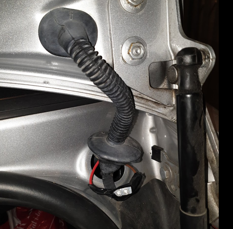

Magnet Posted February 21, 2021 Share Posted February 21, 2021 Hello Scott, Before doing any bodges, check for breaks in the wiring in the fluted rubber section where the harness runs from the body to the boot. Quite common for there to be issues there, due to the flexing of the harness as the boot is openes and closes - particularly in cold weather, when the wires become more rigid. Perhaps you could let us know how you get on. Kind regards, Gareth. Quote Link to comment Share on other sites More sharing options...
Scotty D Posted February 21, 2021 Share Posted February 21, 2021 So, i have fixed it, problem was a broken wire after all, one of the wires inside the black rubber gaitor/sleeve that goes between the body to the boot lid. It had been repaired in the past and was the thicker brown wire. I didn’t see this on first inspection as the repair was good being done with solder so I thought the chances of it having broken again were slim - a wrong assumption on my part. Having gently pulled at the wire, I was delighted when it came out one end broken as I knew then that it was mystery solved and an easy fix. All lights working together with boot lid release button which is working from key fob too. Thanks for the input and happy motoring. Quote Link to comment Share on other sites More sharing options...

ncr Posted January 10, 2022 Share Posted January 10, 2022 Just signed up to say thank you! This thread was the solution to my problem as well 😄 Same exact car as Scotty, and the same wire broken in the same spot: I pulled it out, threaded a new one through the sleeve, reattached the ends with terminal blocks, and everything was fine. Basic stuff for anyone who ends up here in the future: - Yes, the sleeve can just be pulled out of its socket using enough force, and squeezed back in. - You can open the boot mechanically using the key. The hole is right next to the boot button. (The latter might seem obvious, but in another thread, the discussion revolved around crawling in through the back seat rests to troubleshoot.) 1 Quote Link to comment Share on other sites More sharing options...

ncr Posted January 10, 2022 Share Posted January 10, 2022 Piggybacking on the already derailed thread, any thoughts on using simple terminal blocks? 😁 (Pic attached, in case that's not the correct translation.) Quote Link to comment Share on other sites More sharing options...
cliffcoggin Posted January 11, 2022 Share Posted January 11, 2022 I would prefer terminal blocks if there is space because I am unconvinced by Keith's advocacy of twisted jonts. I have seen too many twisted joints fail on cars over the years. However in this particular instance I do not know if there is space for such a block. Either way some slack in the wire, or even better a loop as Keith suggests, would relieve the strain from repeated opening of the boot. I am not an electrician but mechanical locking of two wires together with screws or solder were the only acceptable methods of joining or terminating wires in all my years in industry. The same applies to domestic electrical installations from what I have seen, though spring loaded blade connectors like the Wago are becoming popular. Quote Link to comment Share on other sites More sharing options...
Stagn8 Posted January 11, 2022 Share Posted January 11, 2022 Different experiences lead us all to different preferences 😀 and of course preferred solutions. Terminal blocks work well and I believe from the picture that is what has been used, wrapped in tape for extra protection and most importantly with a loop to remove strain, without that the movement will pull the wires out quite quickly. My beef with them is the difficulty of getting all the strands neatly into the block and once you have tightened the screw only a few wires will actually be under the screw and secured so overall quite a weak join. House wiring is all single core and doesn’t move, soldering, wago, terminal blocks all work well, it is multi strand that causes difficulty. Sorry to derail thread but my own view is that shared knowledge and experience along with discussion, if relevant, should be the backbone of a good ‘forum’. Perhaps I am wrong. Quote Link to comment Share on other sites More sharing options...
Magnet Posted January 11, 2022 Share Posted January 11, 2022 As Cliff points out, ‘choc blocks’ as I call them are used (where absolutely necessary) on domestic electrical installations , so are capable of handling voltages and currents beyond what would be encountered on auto electrics. So in my book, they are fine to use - if space allows. Taking Keith’s point about strands of wires straying away from the actual terminal bore, then I overcome this by first soldering the stub end which then fits nicely into the terminal, and provides a good gripping area for the terminal screw to bite into. Crimp terminals? Now there’s a different story, and personally I don’t like them, based on too many becoming detached, despite using the correct crimping tool. If it turns out it is a must to use them, then again I solder the ends of the wires to improve the bite. Kind regards, Gareth. Quote Link to comment Share on other sites More sharing options...
