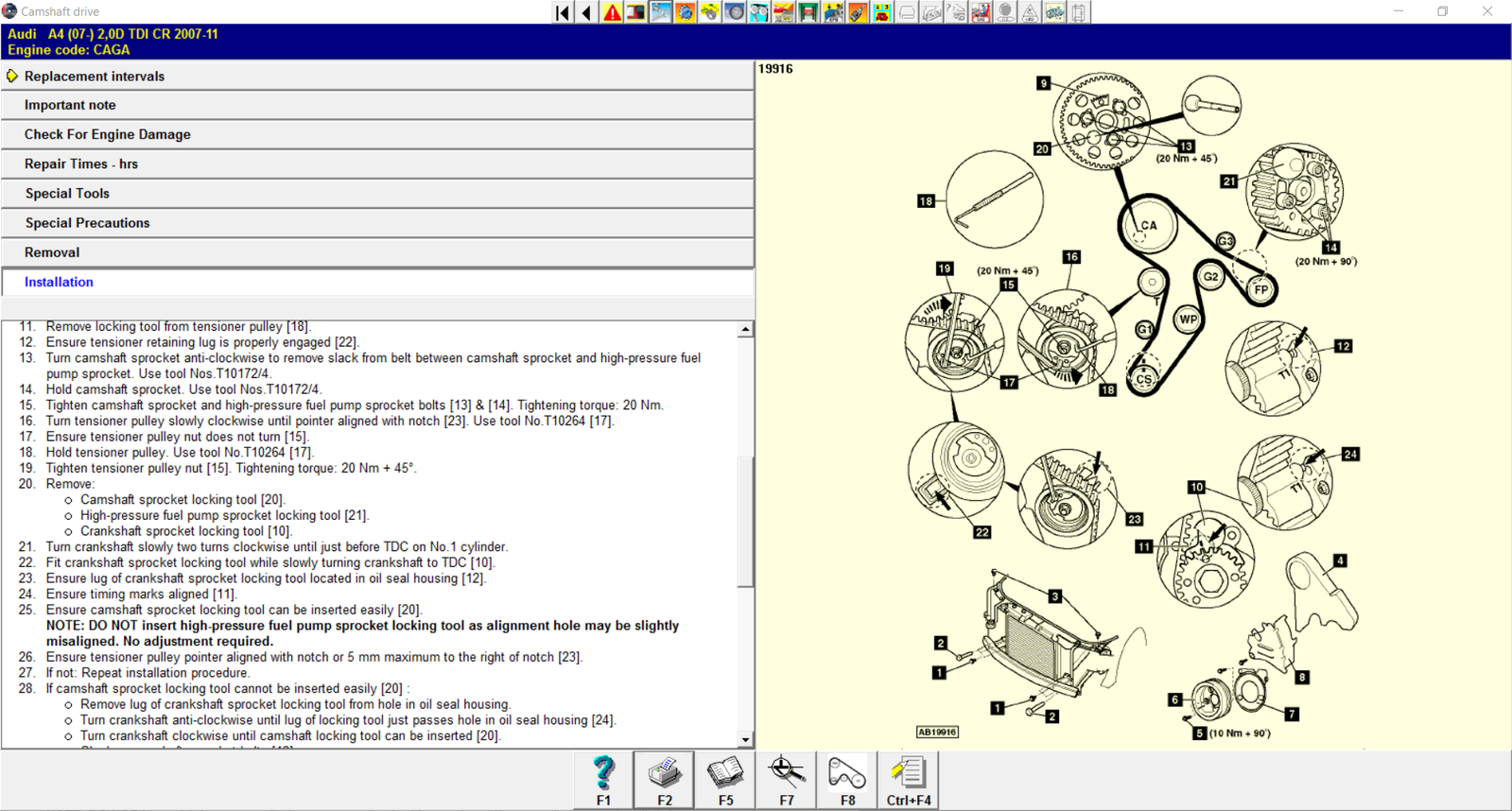

B8sline143 Posted August 13, 2017 Author Posted August 13, 2017 Can anyone shed any light on the position of the tensioner marker. This is taken after the belt had been fitted and car driven, now i know the marker does move back and fourth slightly when car is running, but should it return to the position it was set to (when set correctly, marks lining up) when the car is turned off. Thanks
Via Posted August 13, 2017 Posted August 13, 2017 The arrow should be in line with the notch and no more than 5mm past notch once tightened down. Hard to tell from photo but looks more than 5mm to me. 1
B8sline143 Posted August 13, 2017 Author Posted August 13, 2017 5 minutes ago, Via said: The arrow should be in line with the notch and no more than 5mm past notch once tightened down. Hard to tell from photo but looks more than 5mm to me. It is more closer to 10mm past the notch. When the engine is warm. I am having a independent VAG technician adjust it and hopefully it cures the whine. Do you know if he will be able to adjust it without stripping the front bumper off? Thanks
Via Posted August 13, 2017 Posted August 13, 2017 Guideline is to repeat installation if it goes over 5mm, simple answer is if it is to be done properly then yes would need to come off again and everything aligned and slackened before tensioner reset. I wouldn't trust anything less on these, an older car you could probably get away with just leaning in an readjusting tensioner but more modern cars all the pulleys are spring loaded and have to be set in order otherwise throws timing out.

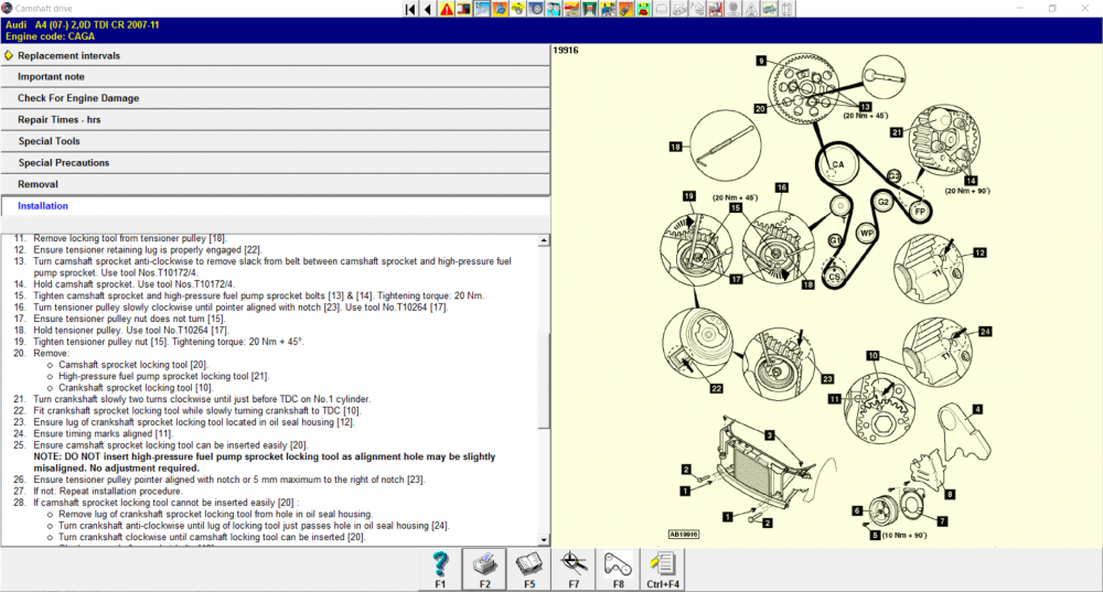

Via Posted August 17, 2017 Posted August 17, 2017 Absolute bull! That tensioner is not hydraulic and certainly not self adjusting... If it was there would be no need for notches and marks. Hydraulic tensioners are much more obvious, they for starters have a visable hydraulic piston (funnily enough) which holds the tensioner in place, normally more common on serpentine belts where you just lever against the tensioner and slip belt on / off. They are used in cam belts but that is not one. Have included a screen shot, point 26 shows 5mm limit. Also judging by that picture I'd guess that roller is old, wouldn't expect it to be looking like that already and back of belt (thats visible at least) has no sign of damage.
B8sline143 Posted August 17, 2017 Author Posted August 17, 2017 3 hours ago, Via said: Absolute bull! That tensioner is not hydraulic and certainly not self adjusting... If it was there would be no need for notches and marks. Hydraulic tensioners are much more obvious, they for starters have a visable hydraulic piston (funnily enough) which holds the tensioner in place, normally more common on serpentine belts where you just lever against the tensioner and slip belt on / off. They are used in cam belts but that is not one. Have included a screen shot, point 26 shows 5mm limit. Also judging by that picture I'd guess that roller is old, wouldn't expect it to be looking like that already and back of belt (thats visible at least) has no sign of damage. Thabks for the replys guys Via, from looking at the pics would you say the tensioner is too tight? What do you make of comments regarding steering rack position causing a noise that is common of these cars?
