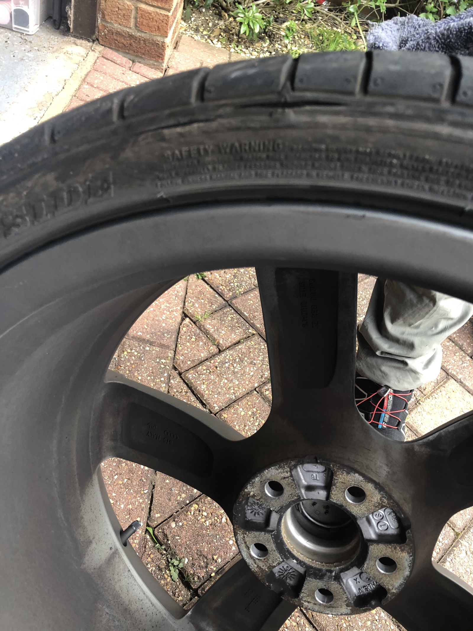

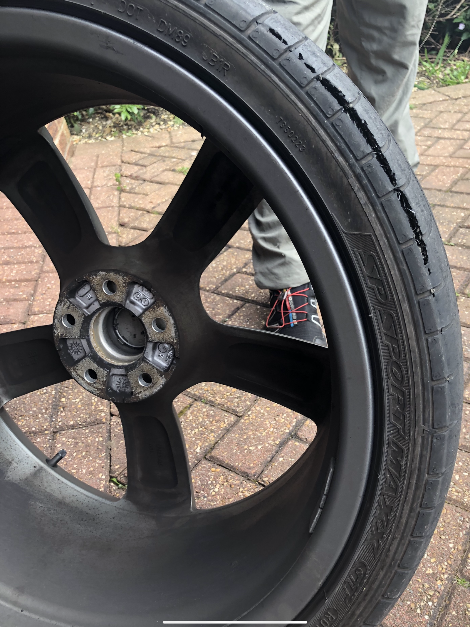

Nic Posted April 1, 2020 Posted April 1, 2020 Dunlop tyre number 7 split tonight. Continental ordered for tomorrow. This is the second post on here, last tyre went in November 2019. Clearly the quality issues continue. For info of others the Continental fitted last time seems to be holding up well.
Audi_Addict Posted April 1, 2020 Posted April 1, 2020 Jesus. That's horrific. What size and how many miles on them would you say.
Audi_Addict Posted April 1, 2020 Posted April 1, 2020 1 hour ago, Nic said: Dunlop tyre number 7 split tonight. Continental ordered for tomorrow. This is the second post on here, last tyre went in November 2019. Clearly the quality issues continue. For info of others the Continental fitted last time seems to be holding up well. Ironically the 2nd picture has the lettering 'safety warning' right below the split 🙄
Nic Posted April 1, 2020 Posted April 1, 2020 1 hour ago, Audi_Addict said: Jesus. That's horrific. What size and how many miles on them would you say. it’s my partners car and she thinks that tyre went on circa May 2019 and has done again circa 5000 miles of mainly town driving with a few long motorway runs. The worst thing is on those motorway journeys we’ve had the children in the vehicle. They are 21” genuine Audi wheels.
