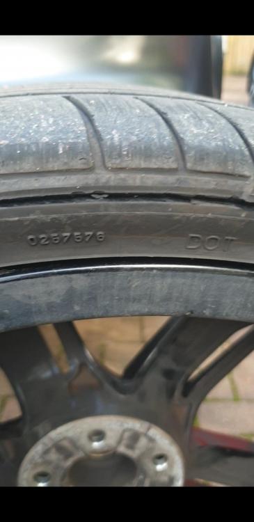

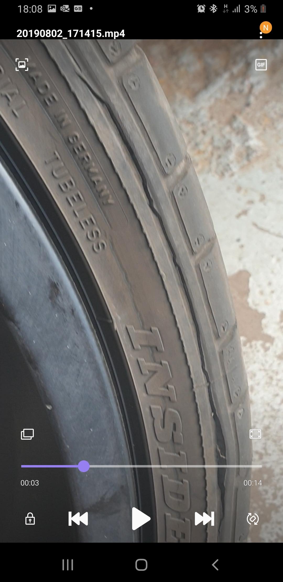

NoFEARfreak Posted April 24, 2020 Posted April 24, 2020 Hi, Same problem with my 4 tyres Dunlop Sport Maxx GT 275 30 R21 (2x DOT 0217 and 2x DOT 5216)
Steve Q Posted April 24, 2020 Posted April 24, 2020 6 hours ago, NoFEARfreak said: Hi, Same problem with my 4 tyres Dunlop Sport Maxx GT 275 30 R21 (2x DOT 0217 and 2x DOT 5216) Now that is really bad.
NoFEARfreak Posted June 7, 2020 Posted June 7, 2020 I send the tires to the importer and after 3 weeks received this answer: Quote The tire is advertised outside the warranty period. It has pronounced double-sided wear on the shoulders. Uneven wear and mechanical damage is not the result of a defect in the manufacturing process, but of the conditions in use. The complaint is not approved.
Steve Q Posted June 7, 2020 Posted June 7, 2020 1 hour ago, NoFEARfreak said: I send the tires to the importer and after 3 weeks received this answer: That's not good! Might be worth making them aware of this thread. Might help shows its a well.known issue. Cheers Steve

Ross Gilsenan Posted July 23, 2020 Posted July 23, 2020 Hi All. I'm in exactly the same scenario on my RS7. I've had quite the scare with a blow out at high speed and one at approximately 40 mph... Not a nice experience and tbh, totally unacceptable. Further to that, I checked the rear tyres and they were also demonstrating the exact same failure to the front! This is a failure of the tyre and one which is clearly a common one... So far, I have raised the issue directly with goodyear. The tyres have been sent back and awaiting their response. However, this is clearly a safety issue and one that has not been rectified over time. I can see owners raising this issue from 2013 up to 2019. The only reason I came by across this thread is in relation to doing some research to take them on with this issue. I was saddened to read about a clear failure in design happening to so many people.To date - All 4 tyres have failed with the exact same issue - Scary!

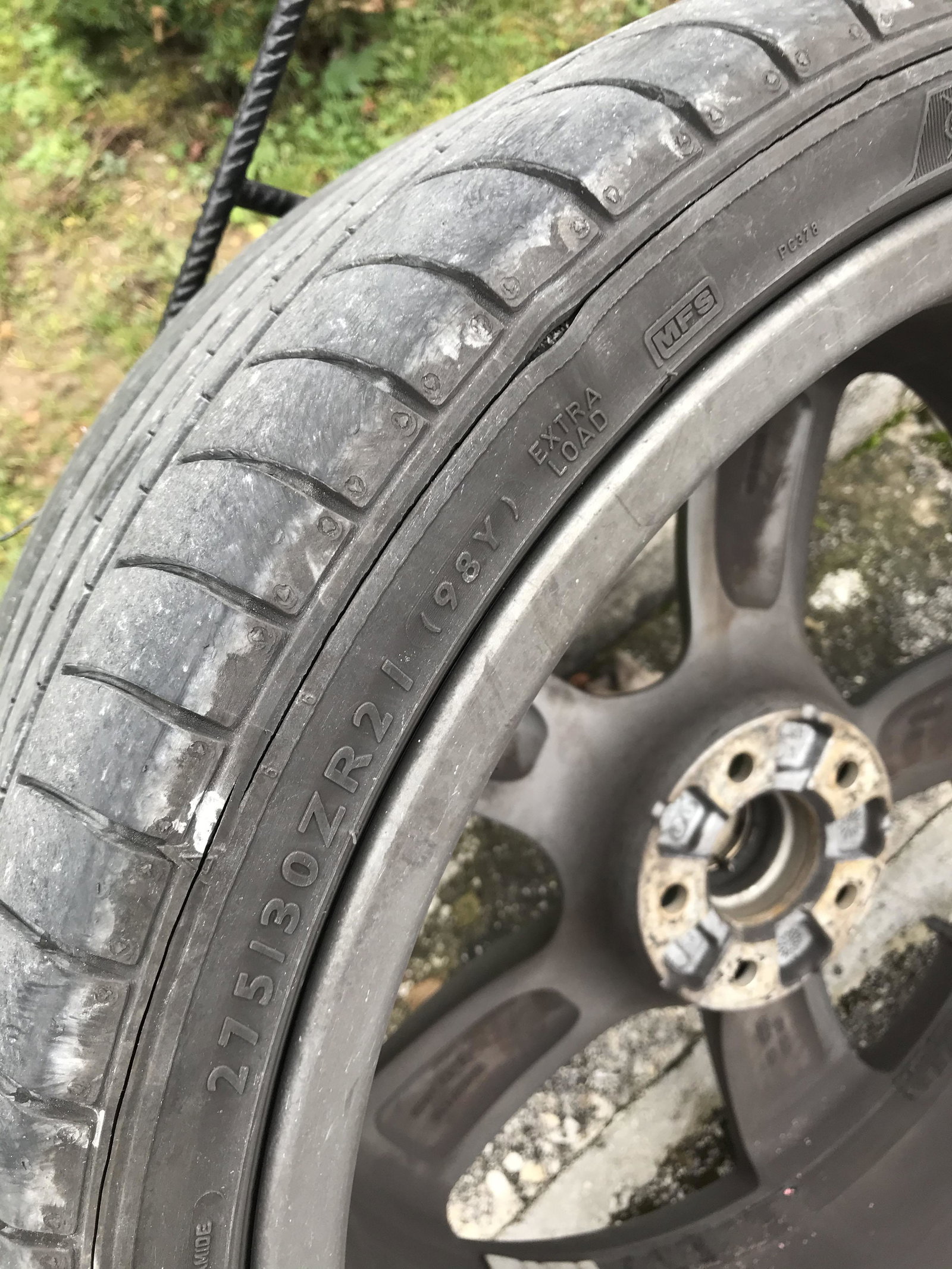

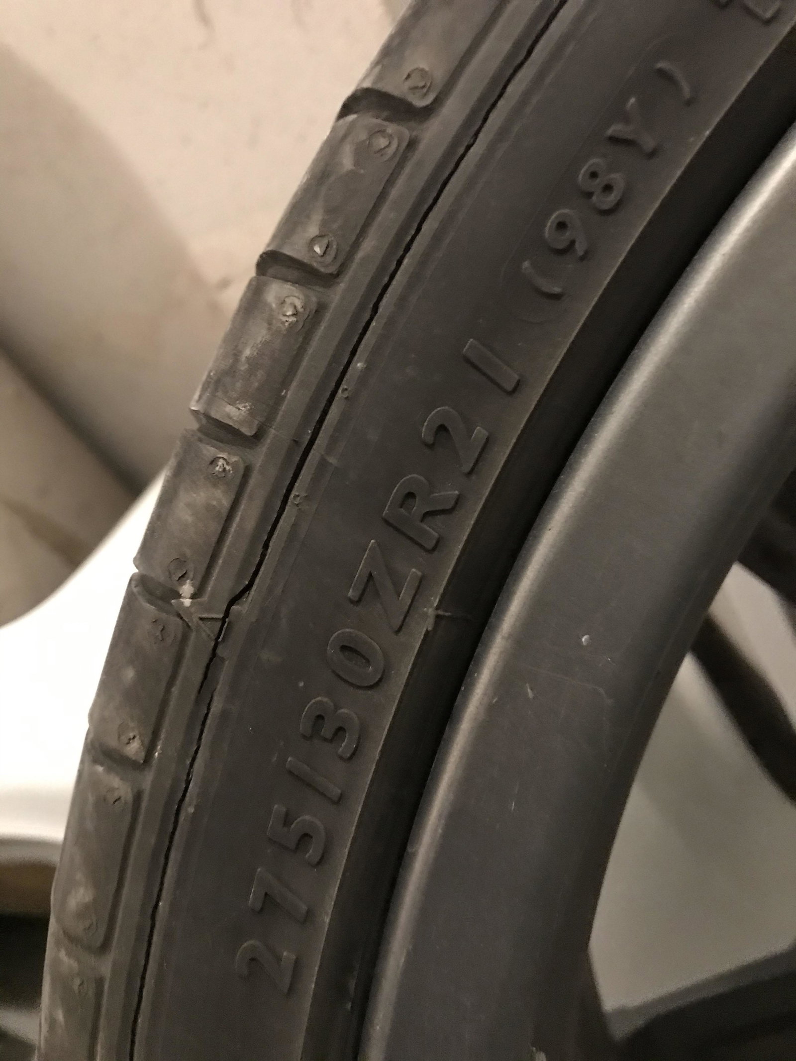

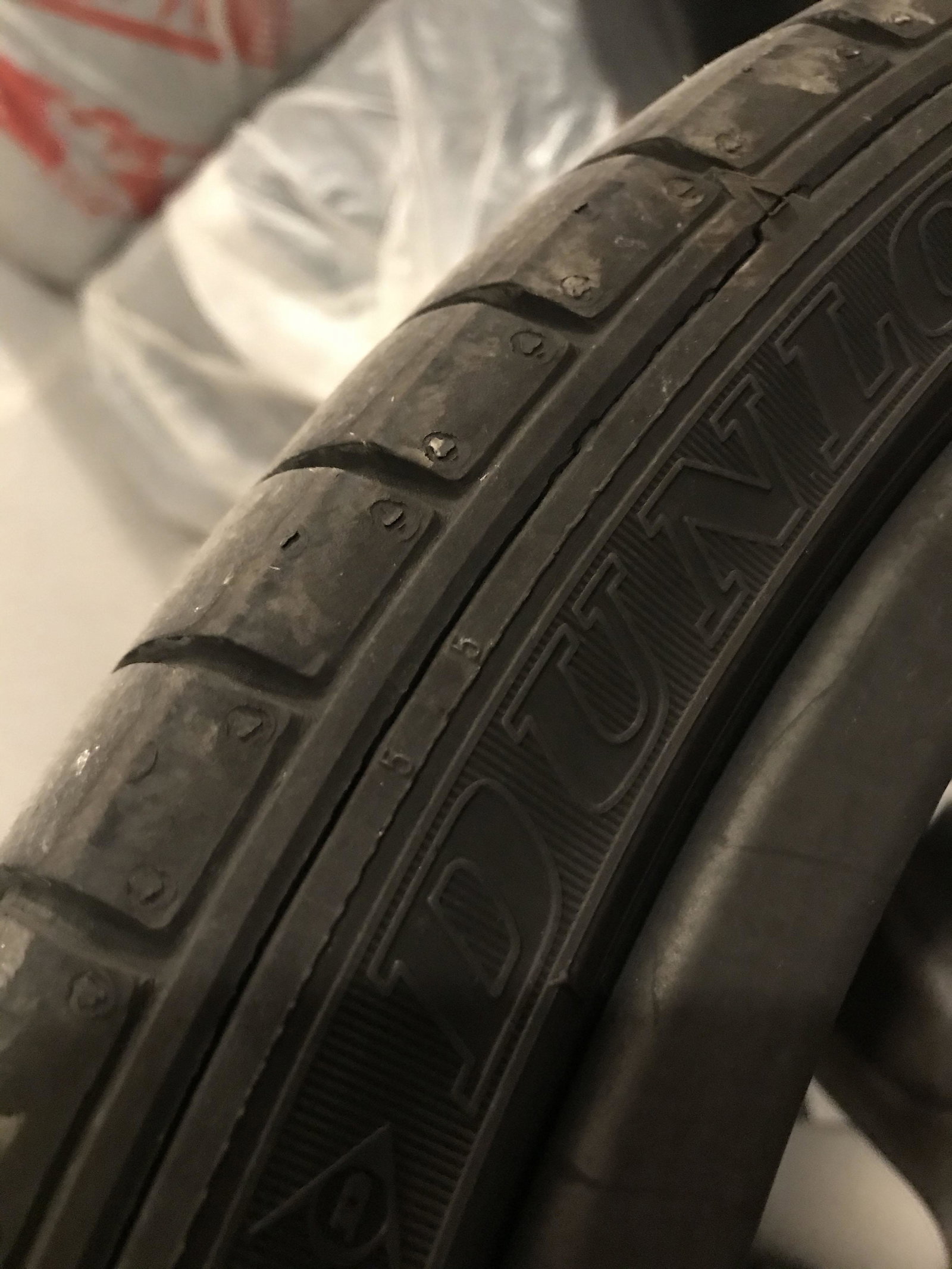

Devilbuick41 Posted October 5, 2020 Posted October 5, 2020 So, to join the lengthening debate. I had two rear blow outs originally and not knowing any better I replaced with like (doh!). Since then I have had the other four tyres go the same way, the rears again being the latest. When the second set went I got the tyres back to Goodyear Tyre UK for examination and in the report they mainly hand their hat on two points; underinflation or accidental impacts which over extend the side wall of the tyres. I take issue with this on the following points: 1. It always seems to the be the inside wall of the tyre that goes, not the outside. Underinflation would cause both side walls to over extend. 2. Accidental impacts appear to be ruled out at tyres crack at the same time across axles, rears, then fronts and then rears again. Suggesting this is a lifecycle issue not underinflation nor impacts. 3. No uneven tyre wear was mentioned in the report which would be the case of underinflation, noting also the tyre monitoring system in the A7 should be sufficient to catch these things or why have it on the car Audi?, hence should be ruled out. 4.Noting the speed rating for the tyres being considerably in excess of UK road speed limits the impact would have to be severe to over extend the side wall and would therefore likely be evident on the wheel itself. I've just written most of the above back to them today asking for 60% of six tyres, as I did get some life out of them, as well as several hours messing around getting replacements. Time will tell........ Steve 1
Ross Gilsenan Posted October 6, 2020 Posted October 6, 2020 Dear Admin Is there a way I can get all these posts compiled into one zip-file - I'm also doing the same across other forums in a bid to escalate this safety issue. My reasons are twofold - I feel that each costumer as an individual claimant are being "fobbed-off", but more importantly, this is a SAFETY issue - We only hear about the people who are sharing their experiences, what about the people unaware of this common failure and continue to drive without checking, or the people that have had a major RTA or heaven forbid worse... Somewhere in the process, something is going wrong that is resulting in the tyre failure - We can't all be driving with under-inflated tyres and accidental impacts - Can we? If I could get a copy of the posts on one file, it would really help in the preparation of a consumer case. I can't believe all the pictures here of a same failure and still, it is happening to some poor driver again and again. Any help would be most appreciated in advance.
Devilbuick41 Posted October 6, 2020 Posted October 6, 2020 Update 6/10/20 - Peter Wayte from Goodyear technical advisor called to say that they won't pay anything out unless they have the tyres for inspection. This means every time there is an issue someone, i.e. the consumer, has to remember to retain the tyres when they are changed and find somewhere that will send them back via the dealer network, not all places will. He has kindly (!) resent the test reports from the previous tyres which only states "The tyre shows clear evidence of having been used over-deflected by overload, underinflation or a combination of both". This does not clearly state what happened just that it isn't a manufacturing issue, which translates as user error. He responded to my comment about failing on the inside shoulder that "Where a vehicle is set up with a negative camber more weight is carried by the inside of the tyre than the outside. Under the circumstances if there are load or pressure issues this is the area most likely to show it." I still don't buy this as this would surely show as uneven tyre wear. For me there is also the question of Audi having OEM wheels and tyres that result in premature failure of the side wall despite there being a tyre monitoring system. If the system is not granular enough to detect low pressures in an OEM tyre contributing to its failure then some culpability rests with Audi. Answers on a postcard please, but I'm considering my next steps are Citizens Advice Bureau or the small claims court. The Consumer Rights Act 2015 describes goods as being fit for purpose and lasting a reasonable length of time. Email from Peter Wayte 26th March 2020 after last set were sent for analysis: "thank you for taking my call and I was sorry to have to advise you no warranty allowance had been recommended by our inspection centre. I have attached the letters which went in the post but it looks as though the submitting dealer did not have your house number or name. The letters are addressed as information is submitted into our computer by the dealer. The examiner felt the tyres exhibited over-deflection. This is when a tyres sidewall can flex more then it was designed to do. After a while it can exhibit splits. This can either happen if the tyres have not had enough air in them, (we recommend checking the inflation every month at a minimum as tyre / wheel combinations will over time lose air), or by overload for example a vehicle is loaded for a journey with family, pets luggage etc. If the vehicle manufacturer recommend higher pressures for such a journey inflating to these is required. The condition can also be caused by a combination of both. I have also added below a couple of pictures for each tyre. Both sets of photos show the sidewall and also the beads. The beads are the part of the tyre which sits on the rim. Both beads exhibited some blueing which is a sign of heat build up and also grooving. Both blueing and grooving are conditions which would be expected to be seen if the tyres have had over-deflection from underinflation or overloading. 400710465 400710446 I appreciate that you are likely to be disappointed by this reply and can only suggest that if you remain doubtful about our decision, you seek the services of a recognized independent tyre consultant, details of which should be available from the British Tyre Manufacturers' Association, telephone 01787 226995. I must point out that we will only accept the findings of a BTMA approved examiner and that you must pay for the examination yourself in the first instance. However, if such an expert believes that your tyre contains any evidence of a manufacturing irregularity, on receipt of their written report we will gladly change our dealer advice to a 100% allowance on the tyre and refund to you the cost of such expert examination. Under the circumstances and given the delay in you receiving the letter I have asked our inspection centre to now hold your tyre for a further 28 days from todays date (26/3/20). I have done this should you decide upon using a BTMA registered examiner. If you are requiring the tyres back for such an examination please as per our original letter, contact the Easy Tyre dealer who returned the tyres to us so they can arrange return to themselves."

Andy Street Posted January 10, 2021 Posted January 10, 2021 I had this problem on my A7 in August 2020. Both rear tyres failed the MOT with 5mm tread due to inner side wall splits (as shown in other posts). Audi Worcester informed me it was common on the A7 and suggested changing to Pirelli in future. Apparently it is due to the lateral movement of the car causing the sidewall to deflect and split. Sadly my wife had passed away 2 days before and I had them replaced without making any fuss. In hindsight, I should have retained them but do have the dealer service video. It's going in for rear brake pads on Monday and I've asked for an inspection report. It's clear that the Dunlop Tyre has a manufacturing/application issue.
