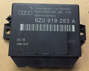

i think the module is in the boot on the left hand side. You'll have to take the boot side trim off. This is also the same for the a4 and a6 c5. I also believe there are 2 different types of module. One that is just for rear sensors and one that is for front and rear sensors.
Unsure on how easy it is to replace though. Iv also attached a couple of images from google as to the boot side and what the part should look like.
Dont go off the part number on the image though as I think the part changed slightly from 2008 on but don't quote me. Just what I'm reading on eBay listings.
