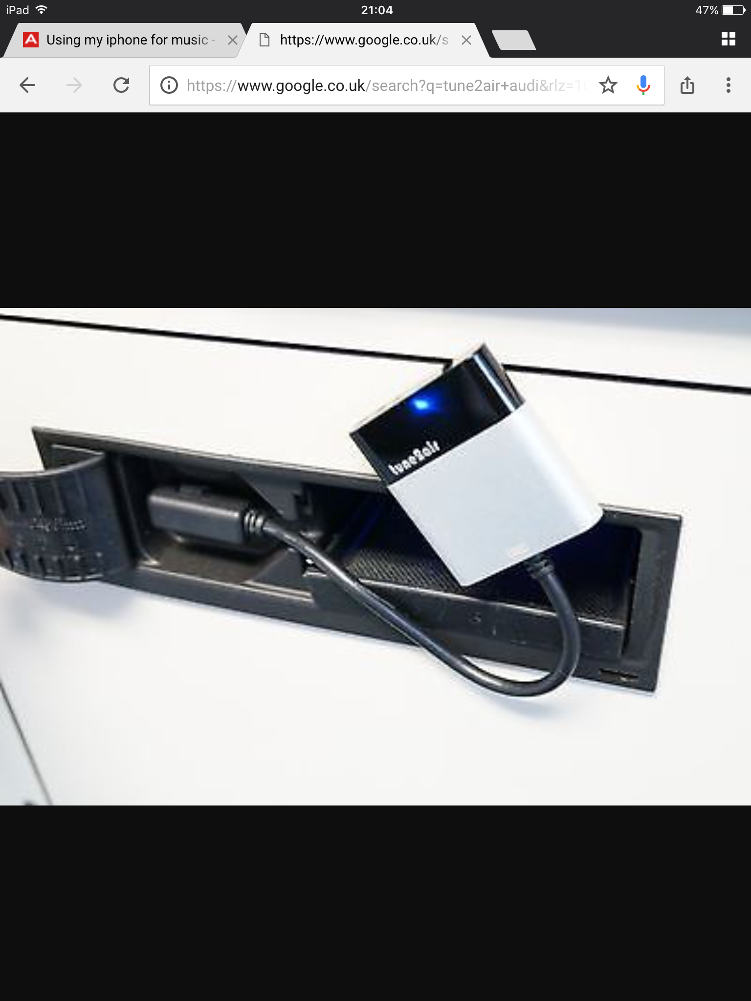

Stuboy Posted September 7, 2017 Share Posted September 7, 2017 Hi I use a Bluetooth device called tune2air that plugs into the box in the glove box. Works well with the iPhone. I paid £60. Money well spent. Quote Link to comment Share on other sites More sharing options...
niedzial1983 Posted September 7, 2017 Share Posted September 7, 2017 1 hour ago, Stuboy said: Hi I use a Bluetooth device called tune2air that plugs into the box in the glove box. Works well with the iPhone. I paid £60. Money well spent. This works with ami with adian does not have on his car Quote Link to comment Share on other sites More sharing options...
adian28 Posted September 7, 2017 Author Share Posted September 7, 2017 Hi thanks for the info and you say I don't have ami? I think I have ami as when I start the car it comes on screen saying ami starting or something like. Would that mean I have ami. Quote Link to comment Share on other sites More sharing options...
niedzial1983 Posted September 7, 2017 Share Posted September 7, 2017 1 minute ago, adian28 said: Hi thanks for the info and you say I don't have ami? I think I have ami as when I start the car it comes on screen saying ami starting or something like. Would that mean I have ami. Check again. I think you will find it says MMI :) If you have the ipod dock then you dont have ami (audi music interface ) its a unit of the size of a cd changer located in the glovebox as showed on the picture above Quote Link to comment Share on other sites More sharing options...
