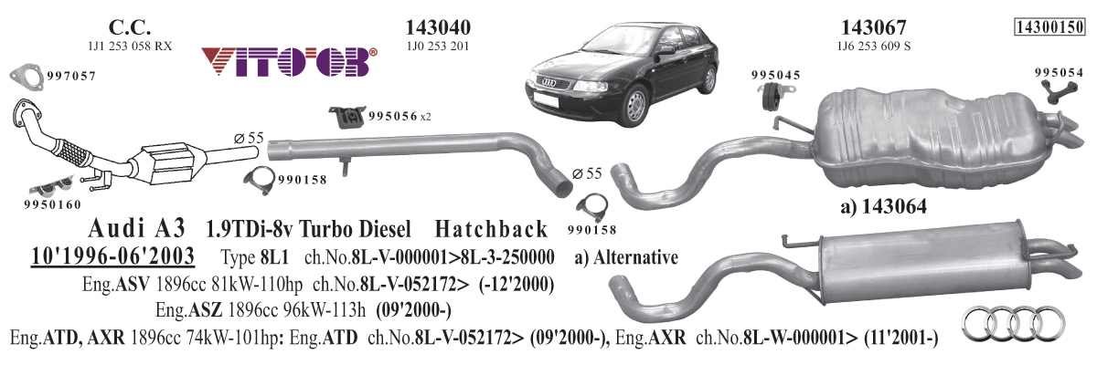

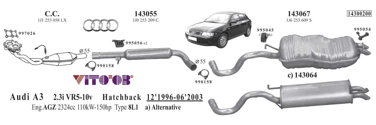

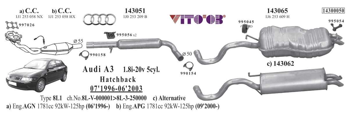

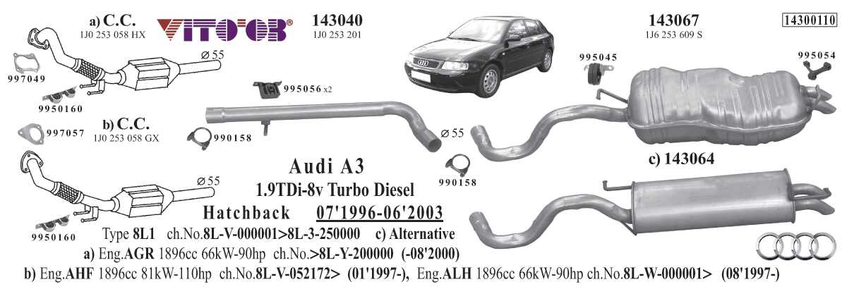

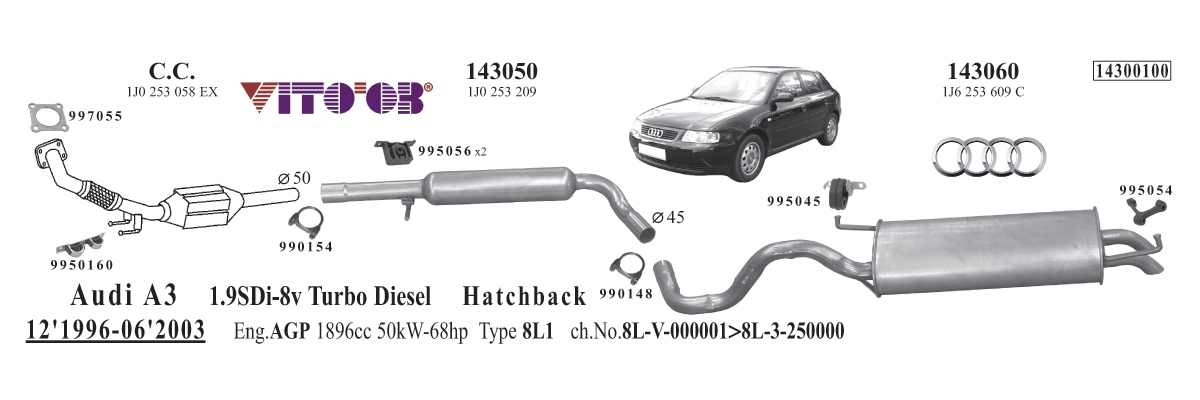

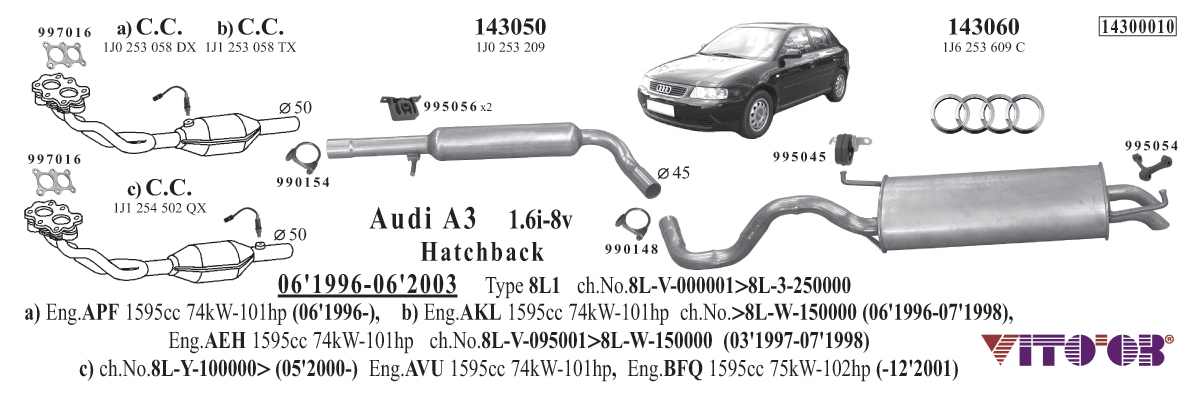

Steve Q Posted October 4, 2017 Posted October 4, 2017 Hi shawsy, sorry this hasn't been answered Sooner! IV found these diagrams, hopefully they are useful to.you. the website I got them from is: http://www.vito03.com/en/exhausts/?make=2 Again apologies this hasn't been answered before now. Cheers Steve
