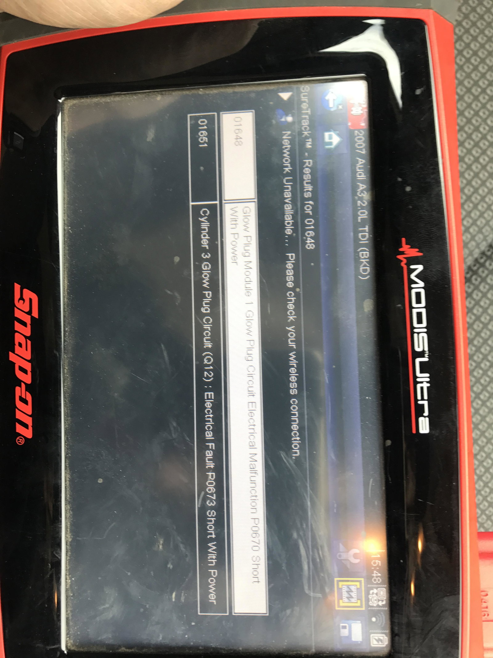

It doesn't look like you have had the fault codes read? If this is true then I think that would be your first step, it may well point to something for you.
But, if it's not injectors I would say either turbo issues or a cracked intercooler.
It would make sense to try to solve the glow plug issue first. These cars have unusual wiring issues. The short here could well be affecting another system.
for example, if I disconnect the front light unit on my T5 (different vehicle I know, but) the main cooling fan comes on!?!
in the mean time check your air filter too. It could be past its best and causing air restriction.
Good point Dann, but this car has an open curcuit in the glow plug system rather than a short (to earth). Getting this sorted may be dsirable  longer term, but if I recall correctly, the glow plugs only operate when the outside temperature drops to 5 degrees C.
