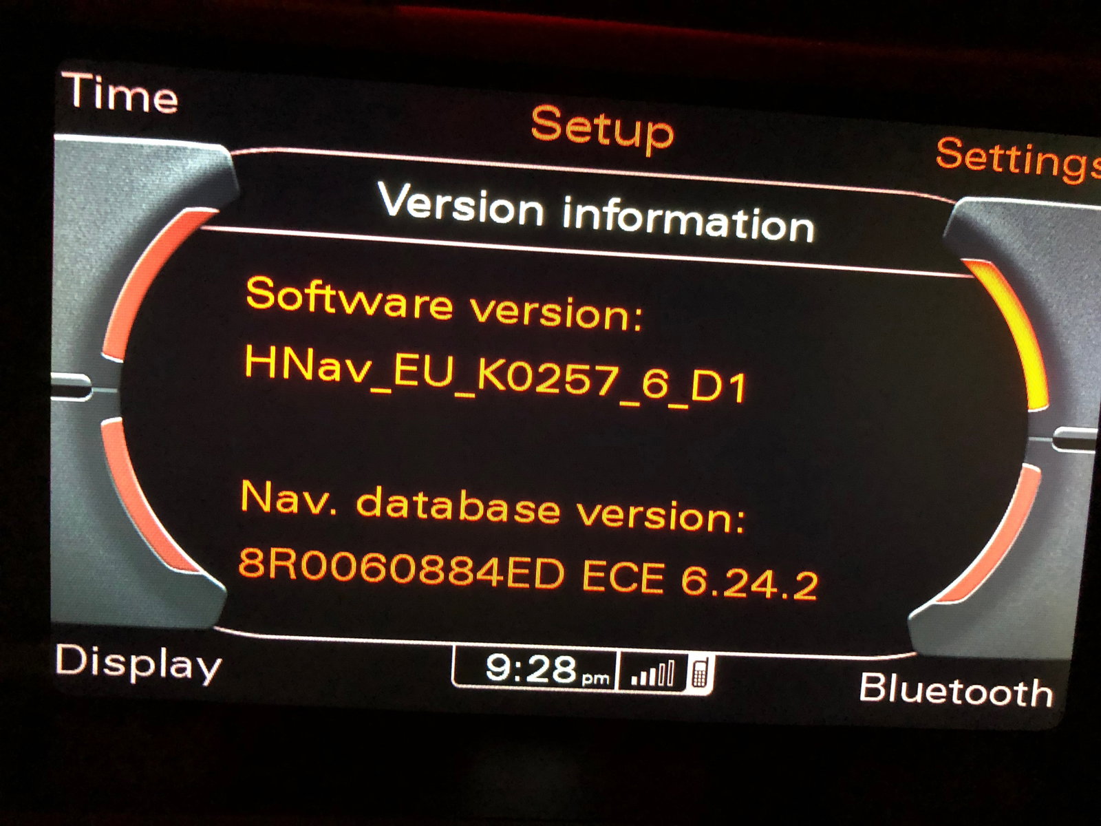

Hi everyone, I'm new here but hopefully someone will be able to shed some light on my SatNav update saga with my local Audi dealer. I have so far taken my 2009 A6 3.0 TFSI to the dealers three times to have the SatNav updated and I'm still not sure it's been done properly.

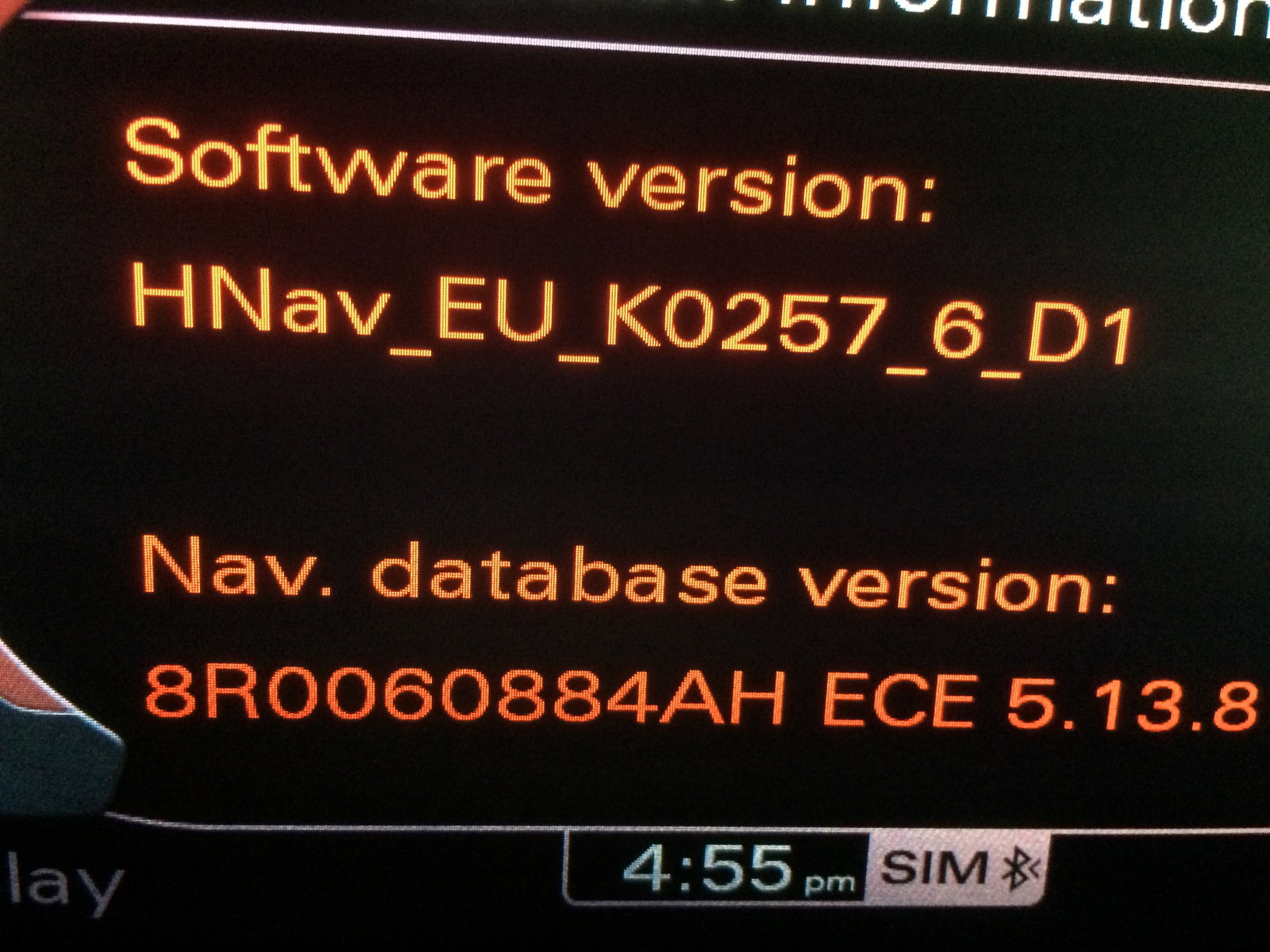

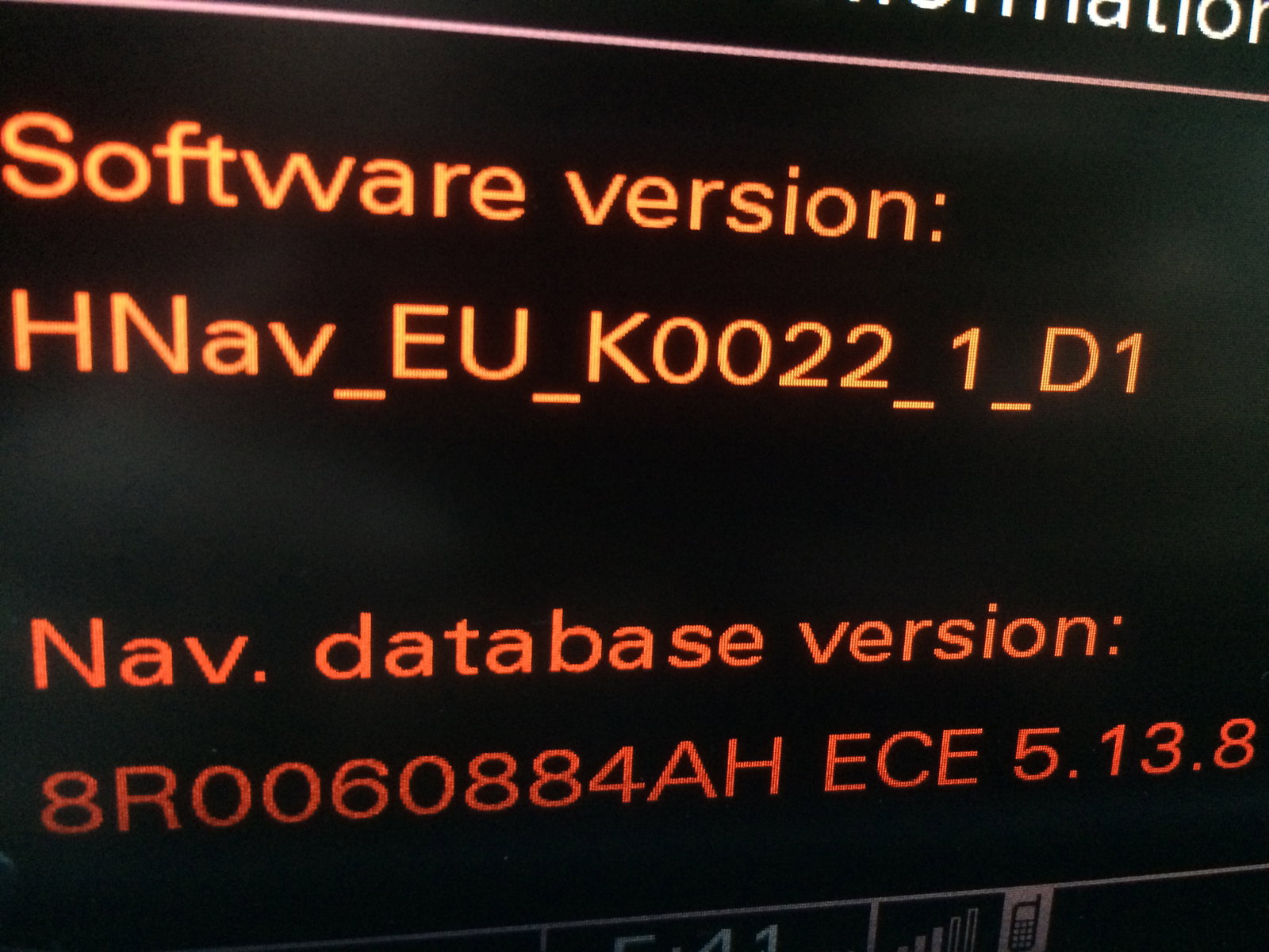

All I have to go on is the version information via the MMI, which even after the second visit had not changed. Both the software version and the Nav database version were the same as before I took it the first time.
HNav_EU_K0022_1_D1 and 8R0060884AH ECE 5.13.8

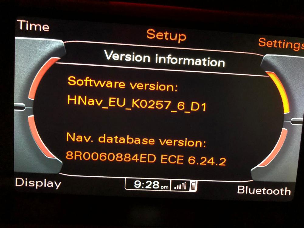

I did find an empty dvd case on the passenger seat with activation codes and pin numbers for the 2017 maps and was assured that all was done. I took the car back a third time and despite them telling me that the the system had been updated but just looked the same, I showed them a photo on my phone of a friends MMI which had been successfully updated and had totally different numbers for the software and the nav database versions. They went away, and this time came back to inform me that the software version was now updated and while the Nav database version has not changed, the 2017 maps are installed. The software version now reads HNav_EU_K0257_6_D1. I don't think the maps are installed but they assure me that their computer readout says they are. How can I prove it one way or another. Apparently the MMI is not reflecting the maps verion installed. Anyone had any experience with Sat Nav updates?

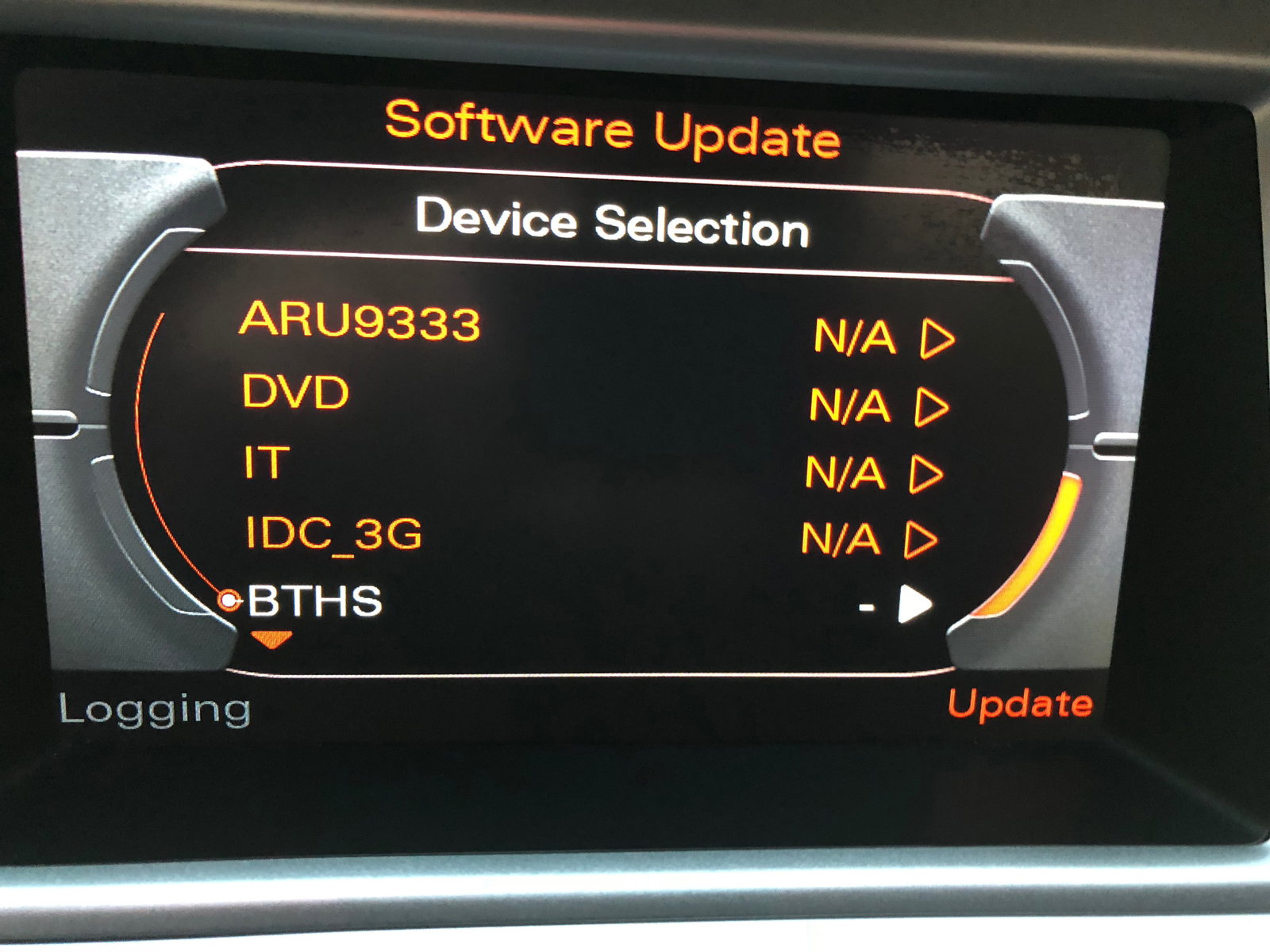

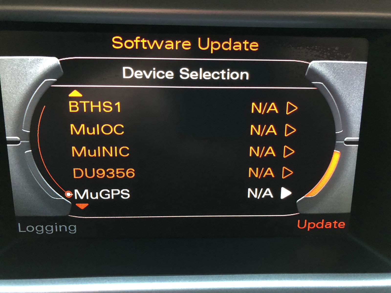

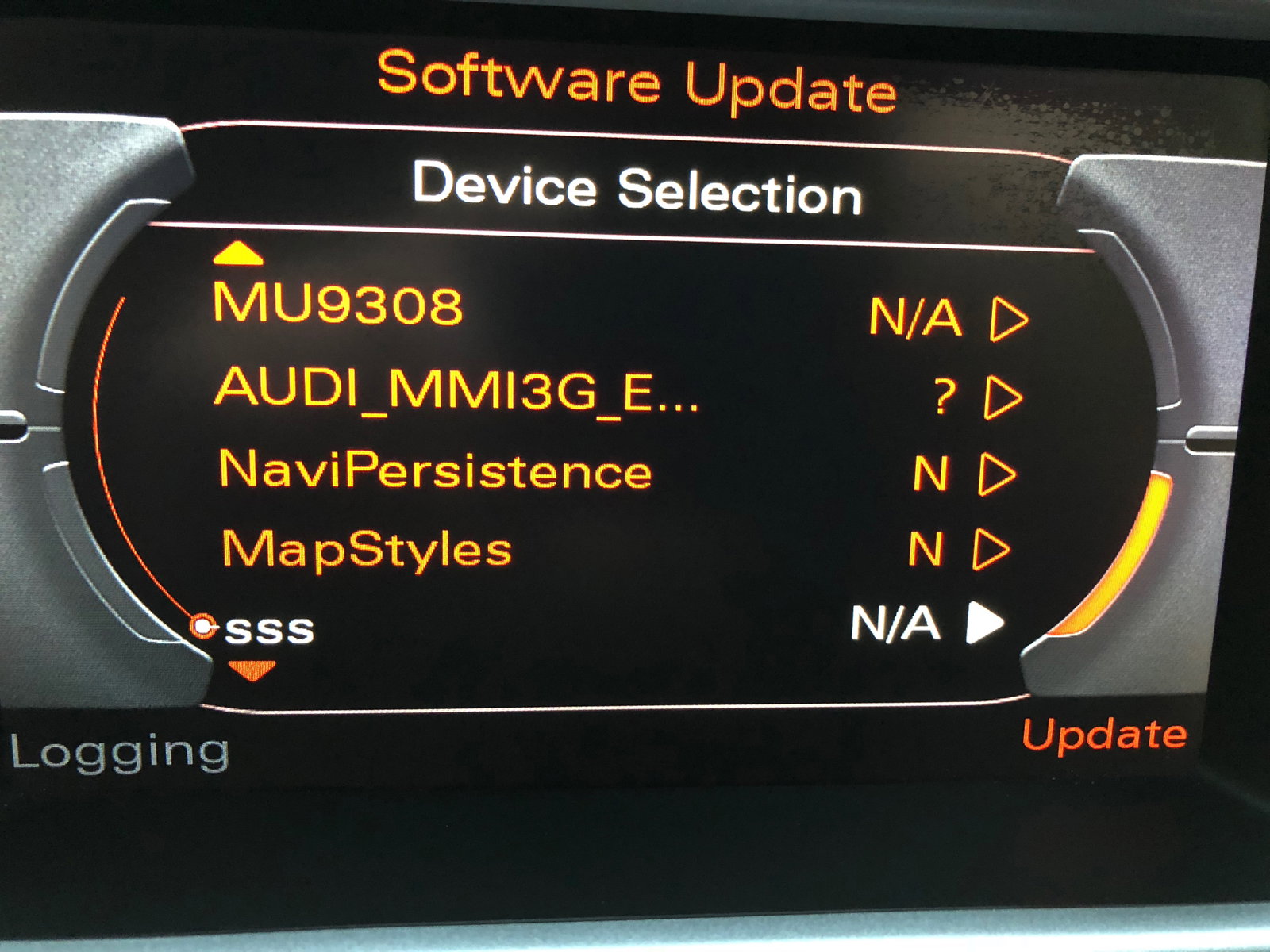

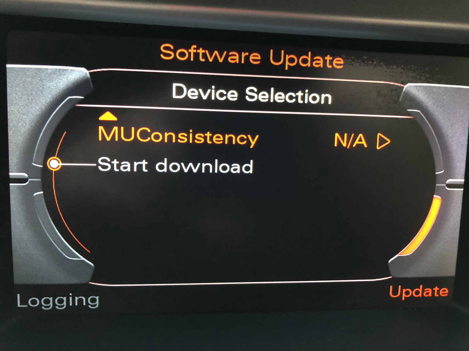

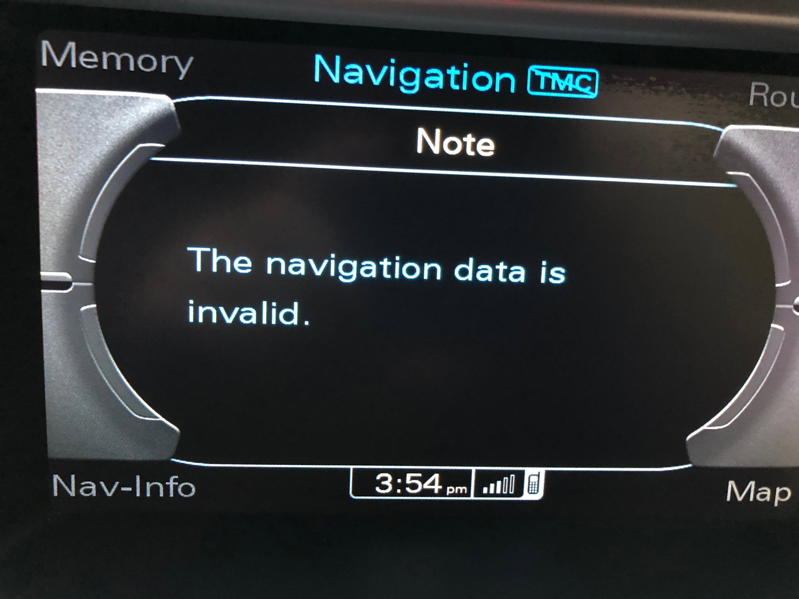

I have managed to get the green menu and delete the old database but now I'm stuck. The download option in the picture is not active. Any idea what I've done wrong? I have no satnav at all now :(
Best regards
Adrian.
