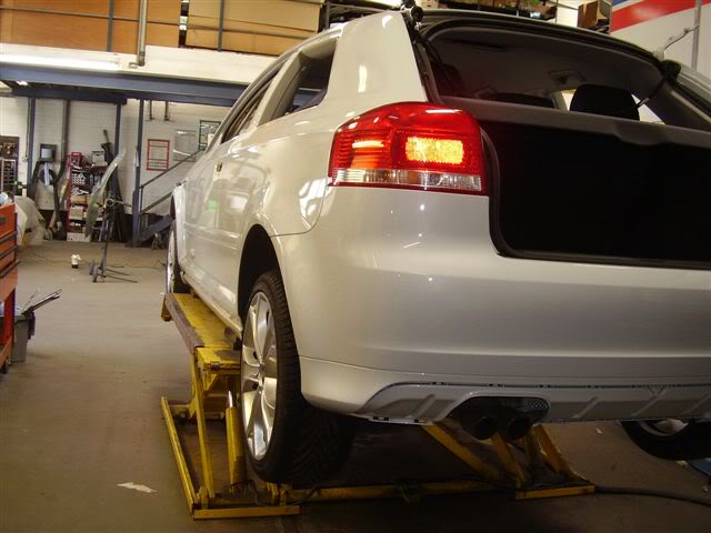

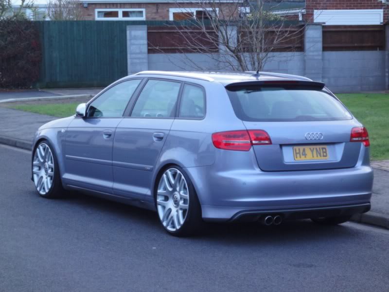

Steve Q Posted November 17, 2017 Share Posted November 17, 2017 Hi Patrick, I think.it depends on which diffuser you get. The pre facelift s3 had a one piece valance where's the facelift valance came in 2 pieces. This therefore affects the fitment of the diffuser. As yours is a facelift I believe you need 2 parts which are: 8p3 807 434 G the grey bit 8p4 807 521K the painted bit To make it easier I'v attached 2 pics. The first one shows the diffuser on the s line. You can see the great piece at the bottom of the bumper and around the exhaust. And the painted piece is the lower part where the line on the bumper is. Hope that makes sense. The second pic shows the painted part with out the grey piece attached. I got the pics off another site. Hope I'v helped :) Cheers Steve 1 Quote Link to comment Share on other sites More sharing options...

Steve Q Posted November 17, 2017 Share Posted November 17, 2017 Well the part numbers I'v provided are for genuine Audi parts and I'd say they'd be the best for got and finish in my opinion. Fitting wise, the lower valance (painted bit) should just unclip from the upper part of the bumper and the grey part should clip in also. Cheers Steve 1 Quote Link to comment Share on other sites More sharing options...
