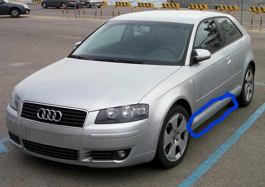

Just bought an A3 53 plate 2.0TDI (8p) and it has the left side door lower plastic trim missing. Anyone know the part number for it? Can't seem to find it anywhere...
BTW  not my car in the pic

I'm unsure on the part number but the technical term for that plastic trim is "door blade" or this is what it's called on my a6 and same for the a4 of the same era.
If you buy.the part new, it'll come unpainted.
Sorry I can't help more.

I have had a look and found these part numbers
8L3 853 959A Left side
8L3 853 960A Right side
I use 7ZAP.com.  Have a look on there as you know your car in better detail
